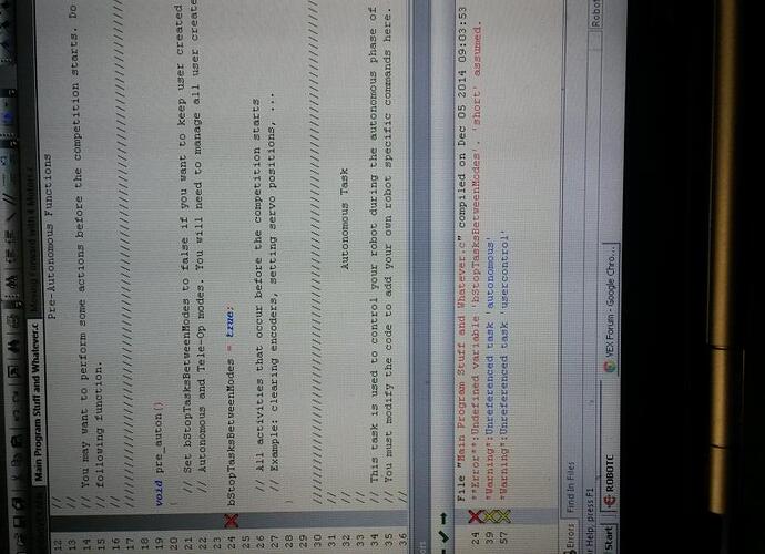

I have been having this error when I reprogrammed my robot: Error:Undefined variable ‘bStopTasksBetweenModes’. ‘short’ assumed.
Is there anyway to fix it and should I be concerned?

Can you please attach a screenshot of the error message?
-Eli

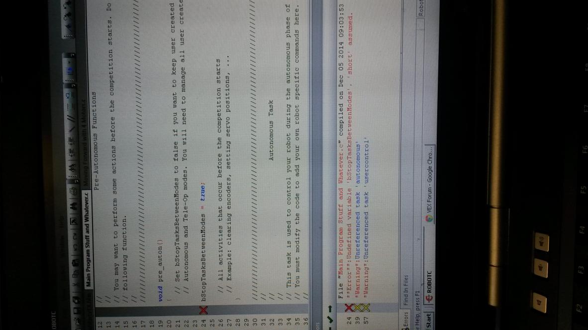

Here is a picture of the error.
[ATTACH]8775[/ATTACH]
And when I try to download sample programs, it says No communications link available to VEX device.
The bStopTasksBetweenModes boolean flag is used to allow or restrict user-created tasks from running in between the pre-auton, autonomous, and user-control phases of a VRC match. This is built into the ‘Vex_Competion_Includes.c’ include file that is included in the Competition Template in ROBOTC.
Usually when we see this issue, it is because the Vex_Competition_Includes.c file is not included in the user program properly. To check for this, please paste the entirety of your code (or, preferably, a smaller program that can cause this issue) as a response to this post by using the
 tags.
