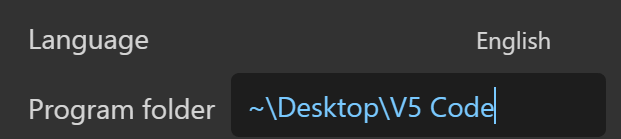

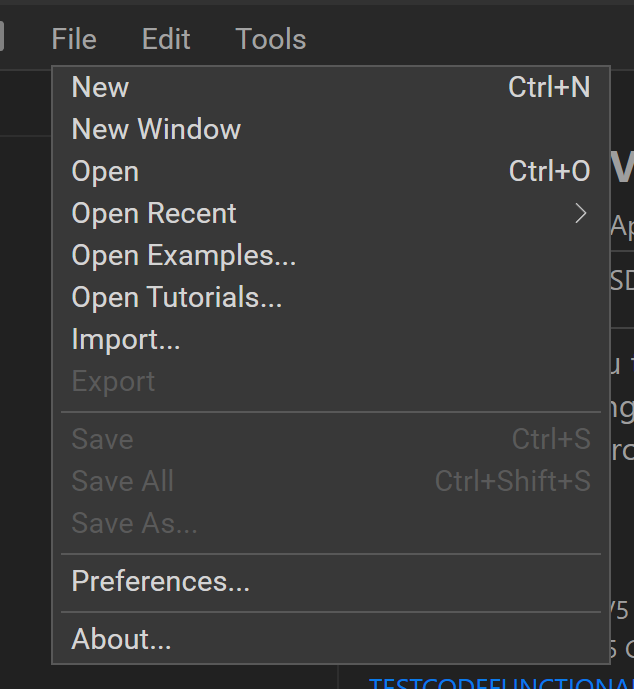

I’m pretty sure there are two things wrong here. First, the file or folder you’re trying to save it to doesn’t exist, and there is something wrong with the code (seen in "closed with exit code:2). I would suggest going to the settings section and redoing the default folder and try to fix the exit code error.
Click the preferences to find the settings

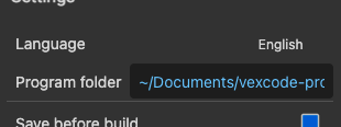

It doesn’t seem like I can change the default folder, nothing happens whenever I click or try to type anything.
Screen Shot 2021-08-18 at 8.28.11 PM
edit: also, I’m able to change the program folder on my Windows installation (which is also able to build the project)
Try restarting the program and make sure you have it saved before you do so. I’m able to click on it and adjust the save place. I don’t know how it might work as I’m on windows 10.
Clicking on it still does nothing after restarting the program, even though it does work on my windows 10 pc, as you’ve said.
