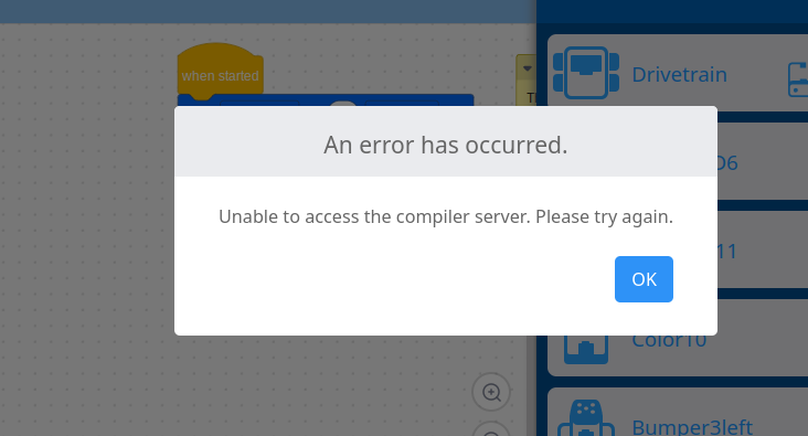

Any help would be greatly appreciated. I have a group of teachers that keep getting this error on Chromebook devices when trying to download code to Robot Brain. Can’t access compiler server. Thanks in advance.

There’s three different potential issues that could occur on a Chromebook -
1. “No Internet Connection” - This error message would mean that the ChromeOS is reporting to VEXcode Blocks that it does not have a connection to the internet. This means either the Chromebook is not connected to the internet or VEXcode Blocks is being blocked by a system policy to prevent general Internet access. Behind the scenes, this check is querying “content.vexrobotics.com” to validate internet connectivity.
2. “Unable to access the compiler server”- This error message would mean theChromebook does have a valid internet connection (via ChromeOS system check + querying content.vexrobotics.com) but is not able to talk to our AWS-based Cloud Compiler. The cloud compilers currently live here:

So most likely issue is a network blocking port 5636 and preventing the cloud compiler from receiving a response.

Experiencing problems downloading code to brain from iPad. It says :
Unable to access compiler server. Please try again.

Our IT went through the URL , the Port number it was trying to get to. It was being picked up on our end as “threat” so they fixed the issue, buy adding it to the exceptions list for all of our school. Apparently it was going to two sites? All good now :slight_smile:
