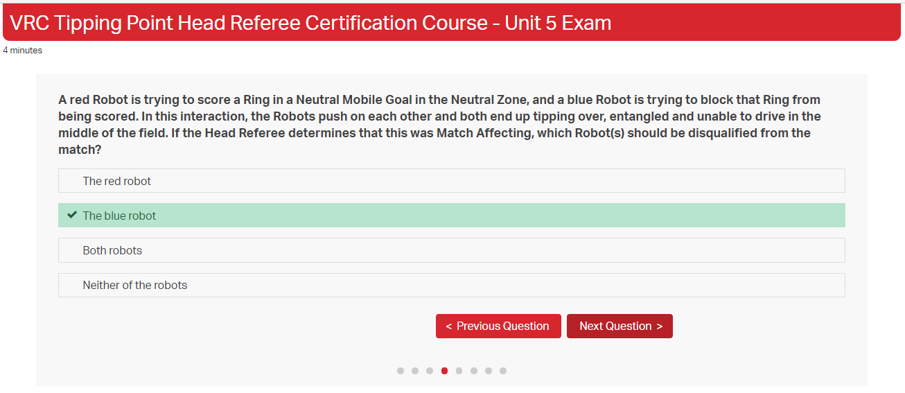

This question is very similarly worded to how it was in last year’s test, and my concern with it is identical to my concern with it last year.
G12 states:
Don’t destroy other Robots. But, be prepared to encounter defense. Strategies aimed solely
at the destruction, damage, tipping over, or Entanglement of opposing Robots are not part of the ethos of the VEX Robotics Competition and are not allowed. If the tipping, Entanglement, or damage is ruled to be intentional or egregious, the offending Team may be Disqualified from that Match. Repeated offenses could result in Disqualification from the entirety of the competition.

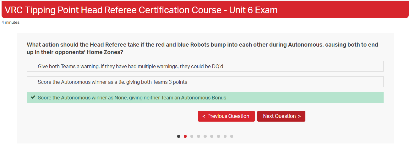

The question asserts that the interaction was match affecting. However, G12 makes no mention of “match affecting”, only whether the tipping is “intentional or egregious”. Therefore, whether the interaction was match affecting or not is irrelevant; only whether the interaction was “intentional or egregious”. Since we are not given this information (and common sense says it was not intentional due to the fact that the blue robot also tipped over), I do not see a reason that the blue robot should be DQed.

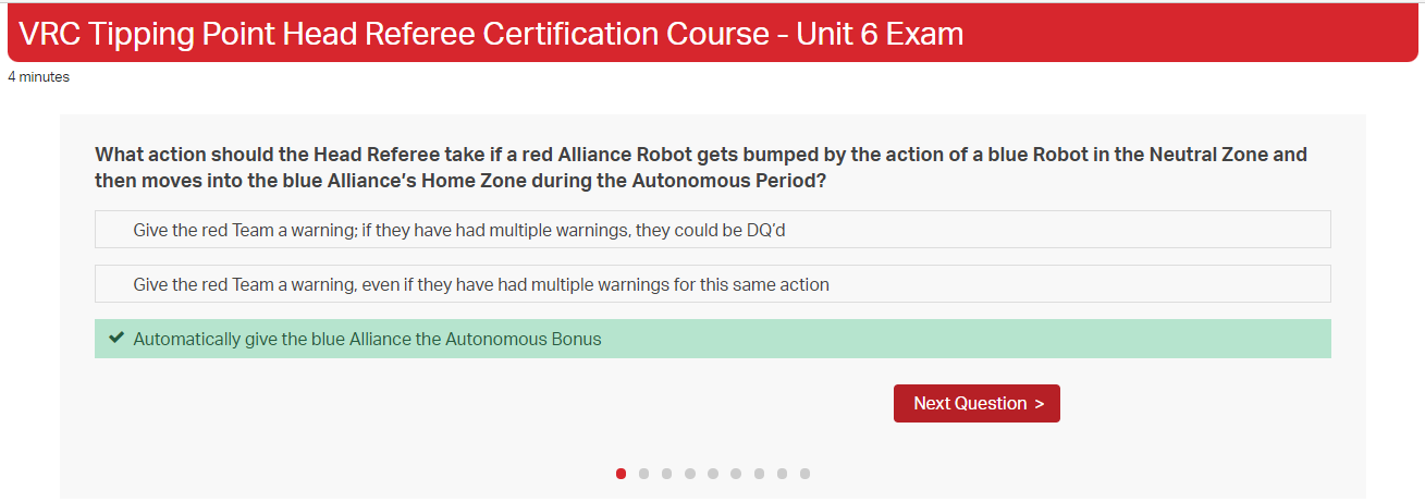

Assuming the SG4 violation was incidental, this seems like a textbook case of SG5c, which states:
If opposing Robots contact one another while both engaging with the Neutral Zone, and an incidental violation of SG4 occurs, no penalty will be assessed on either Alliance
Therefore, the blue alliance should not be automatically awarded the alliance bonus and autonomous should be scored as normal.

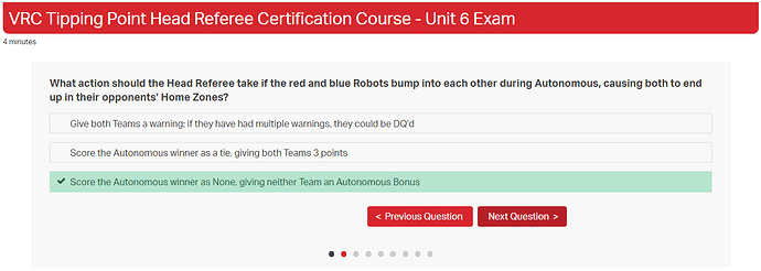

This is very similar to the last question. The interaction sounds to be incidental, so SG5c applies, meaning no autonomous bonus penalties would be assessed, and the autonomous period would be scored as normal.

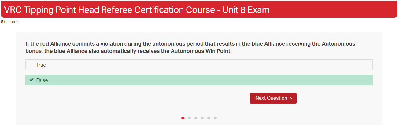

I’m not sure what’s going on with this question; it pretty clearly directly contradicts SG4, which states [my emphasis]:
Stay out of the opponent’s Home Zone during Autonomous. During the Autonomous Period,
Robots may not contact the foam tiles, Scoring Objects, Robots, or Platforms which are fully contained in the opposing Alliance Home Zone.
Violations of this rule will result in the Autonomous Bonus being awarded to the opposing Alliance. The opposing Alliance will also receive an Autonomous Win Point, regardless of whether they completed the Autonomous Win Point tasks. Intentional, strategic, or egregious violations, such as intentional contact with an opposing Robot completely within their Alliance Home Zone, will result in a Disqualification.
Blue should automatically receive the Autonomous Win Point.

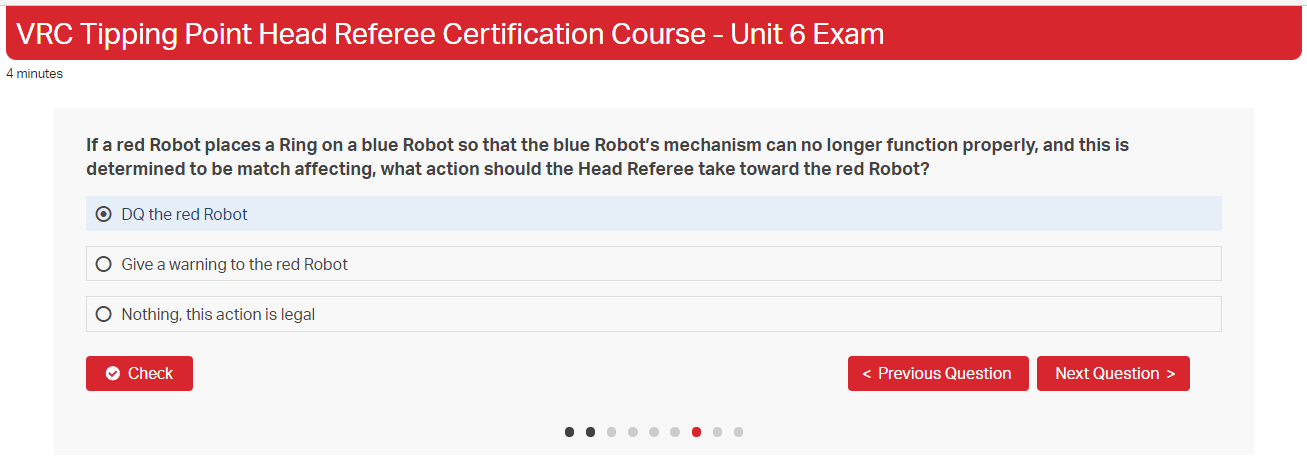

For this question I’m not sure what rule is attempting to be applied here. G12 has no mention of “preventing a mechanism from functioning properly”, unless doing so involves intentional/egregious destruction/entanglement, which doesn’t appear to be the case here. I would like to hear from the writers of the test which rule is being applied in this scenario; otherwise I don’t see how this is a warning, let alone a DQ.

Looks like would apply here. …“If there are any conflicts between the Game Manual and other supplemental materials (e.g. Referee Training videos, VRC Hub app, etc), the most current version of the Game Manual takes precedent.”
I would rule this as a violation of SG10. I see this as being used as a glove to violate G12, entangling a robot intentionally by putting a ring into the opposing robot.
That’s how I would look at it too for this case, so a DQ. In the real world, was it placed or bounced in there would drive what the call is.
From SG10 "The intent of this rule is to prohibit teams from using game objects as “gloves” to loophole any rule that states “a Robot may not [do some action]”. This rule is not intended to be taken in its most extreme literal interpretation, where any interaction between a Scoring Object and a Robot needs to be scrutinized with the same intensity as if it were a Robot."
I could see this being a valid interpretation, but it would have to be pretty egregious to be something to DQ over. It’s not like the blue robot is going to just be sitting still so the red robot can carefully position a ring just right so that it jams a mechanism. I can see something like this happening accidentally, but I can’t see it being intentional.
Honestly, if your robot is so poorly designed that a ring falling onto the moving target of your robot has a decent chance of breaking it, you should have built a more robust robot.
In the context of the question, the red robot places a Ring in the blue robot’s mechanism, therefore causing it to be dysfunctional. In the wording of the question, I view the word “places” to mean that the Red alliance intentionally and egregiously put the ring into the Blue robot disabling their mechanism and should be a dq for the Red robot or Red alliance based on if the match is a qualifier or a elimination.
Sure, I guess my concern is that by including this question in the official list of questions, it might prime more inexperienced referees to apply that a little bit too zealously.
“This robot dropped the ring into the other robot, it caused the robot to stop working, now this team wants me to DQ the team because they couldn’t do anything for the entire match, I’m not sure if it was intentional or not, I can’t find the rule in the rulebook, but I remember something like this from the referee test… uh, DQ, it was definitely match affecting”
It’s the combination of being very subjective, being very (in my opinion) unlikely, and being a few logical steps removed from an actual referenceable written rule that concerns me.

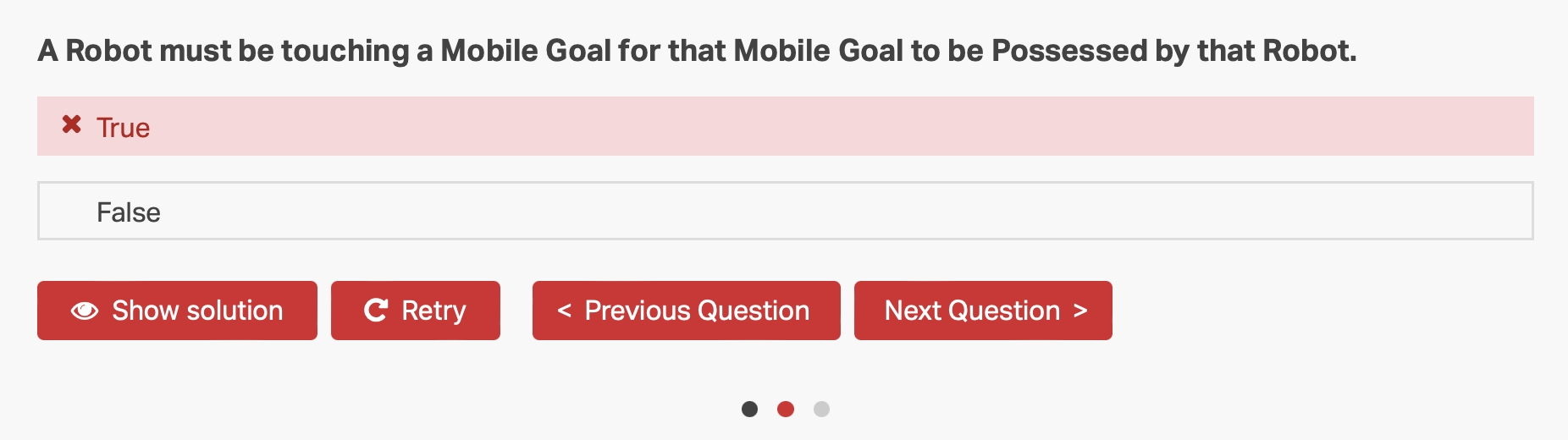

I think this question is out of date with v2.2 of the game manual:
The definition of “possession” given in unit 4 of the certification course (which was also present in previous versions of the game manual) is:
Under that definition, a robot could be “possessing” a mobile goal without touching it. However, in v2.2 the definition was changed to:
and I think this new definition eliminates the possibility of “possessing” a mobile goal without touching it.

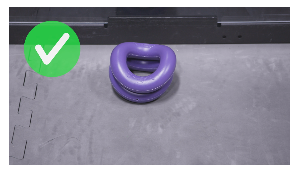

Head Reffing my first event this season tomorrow, so I completed the certification yesterday. All of the above errors in the questions are still present. In addition, I noticed this in the referee training video discussing match loads embedded in the training.
This scenario is shown as an acceptable, but seems like a clear violation of SG8
SG8a: Match Load Rings must be gently placed onto one of the gray foam tiles directly in front of the Alliance Station, i.e. the tiles coincident with the field perimeter wall.
Per SG8a, you must place rings onto a gray foam tile and not another ring.
