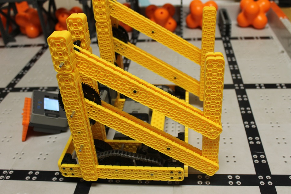

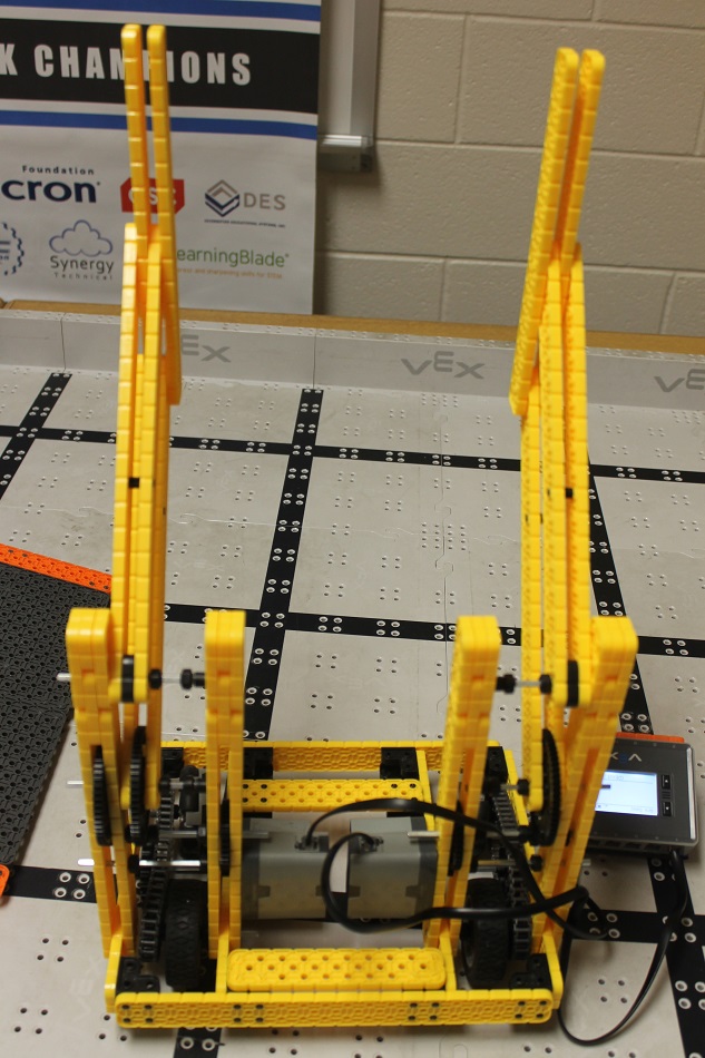

I concur with what as been said already: YouTube videos, past games, etc. I have my kids look at these lifts on VEX bots then we figure out how to “IQ” them. We’ve had success with 4 and 6 bars. I know some teams at worlds have pulled off successful scissor lifts too (we’ve never tried). Unlike VEX, the plastic in IQ has limitations with regard to supporting weight and strength. Supporting the weight is the bigger challenge for our kids than actually building them. I attached one a team built last year (before they changed designs). It was based off of a VEX design. Once we put the vertical beams where we did we were able to figure out how to add the gears in there. The arms are pinned to those 60 tooth gears you see.
