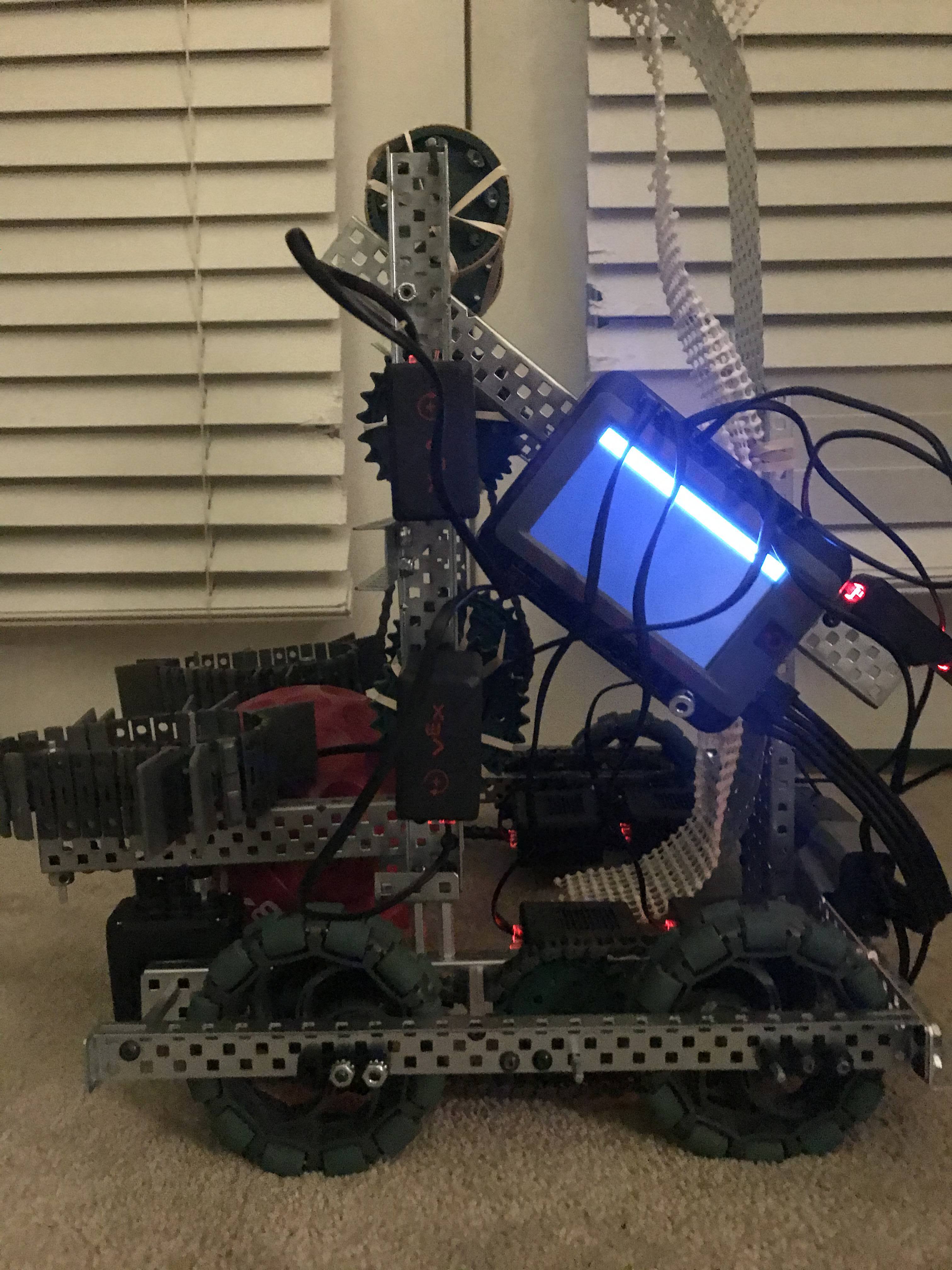

Also what are your guys thoughts about using stand offs for essential parts of the robot? I find that they lossen pretty easily and I am trying not to use them too much but it’s hard
IMG_6942
as you can see from the photo my lift is being elevated by stand offs and I am wondering if this is a janky building practice
It is okay to use standoffs, but I would strongly recommend using loctite or off-brand equivalent to keep them from unscrewing.
yeah that was actually the video that made me realize I should do it for my robot as well… thanks!
What do you mean by using loctite to keep them from unscrewing? Is it using nylon spacers on either side of the stand off?
If you can, have where the lift is built get a c-channel long enough to reach your chassis. And make sure it can at least line up with two hole going down if you know what I mean. This can help make is a lot more stable. And if you are having problems with standoffs loosening you should add more bracing to that piece and then you can also get locktite.

Locktite is a substance you can buy and put it on bolts and stuff like that. It enhances the friction to make it harder to become lose.
wow I had no idea, thanks guys! I assume I use this once ive finalized my build because this looks like it will be hard to come off
