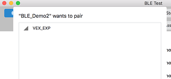

EXP does work a little differently from V5, but connection tools can usually still filter, for example, here is a web ble demo I use and it just shows an EXP brain despite there being numerous BLE devices in my house. We have other products also using BLE, IQ Generation 2, GO, 123, they all advertise in a way that we can differentiate between them.
