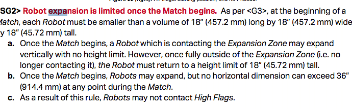

I believe outside the expansion zone there is no vertical expansion allowed whatsoever, however I believe you are allowed to expand horizontally up to 36 inches.
yes, so you could have an 18" tall pancake that goes to a 36" circle outside the expansion zone, (starting in 18" cubed) then if your touching the expansion zone your pancake could be an infinitely tall 36" in diameter cylander.

What if you expand vertically, and then leave the expansion zone?
I read through the manual, but I don’t remember reading anything about leaving the zone expanded vertically.
It quite clearly says right there: The robot must return to a height limit of 18"

Are you allowed to be expanded when you are mostly in the expansion zone, but 2wheels are out
As long as one part of your robot is touching the zone then you are fine
