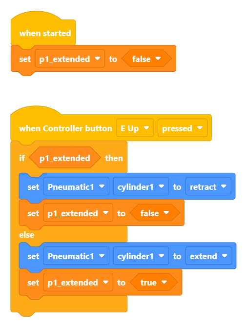

Hi, would anyone be able to help me solve the issue below?
How would i be able to use the same button for extending and retracting the pneumatics cylinders?
Hello Yuki,
You can do something like that by creating a Boolean variable to track if you have extended or retracted your cylinder.
Here is some block code demonstrating that technique:
thank you for your advice, it worked perfectly!
