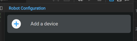

To view what things do in vexcode, add your necessary sensors (in my case, I will add a motor):
How to add a motor
  1. Motors and sensors setup, top right of the screen
    Screenshot 2021-11-27 154619
  2. Add a device
    Screenshot 2021-11-27 154518

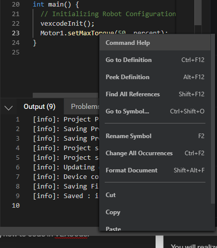

As you can see, motor commands are added. If you wish to learn more about it, copy the command and paste it into your text editor:
Screenshot 2021-11-27 154651
Then, right click the command (in this case setMaxTorque) and click “command help”
Screenshot (477)
A menu with in-depth information will tell you what everything does, what is returned, and how it functions.
