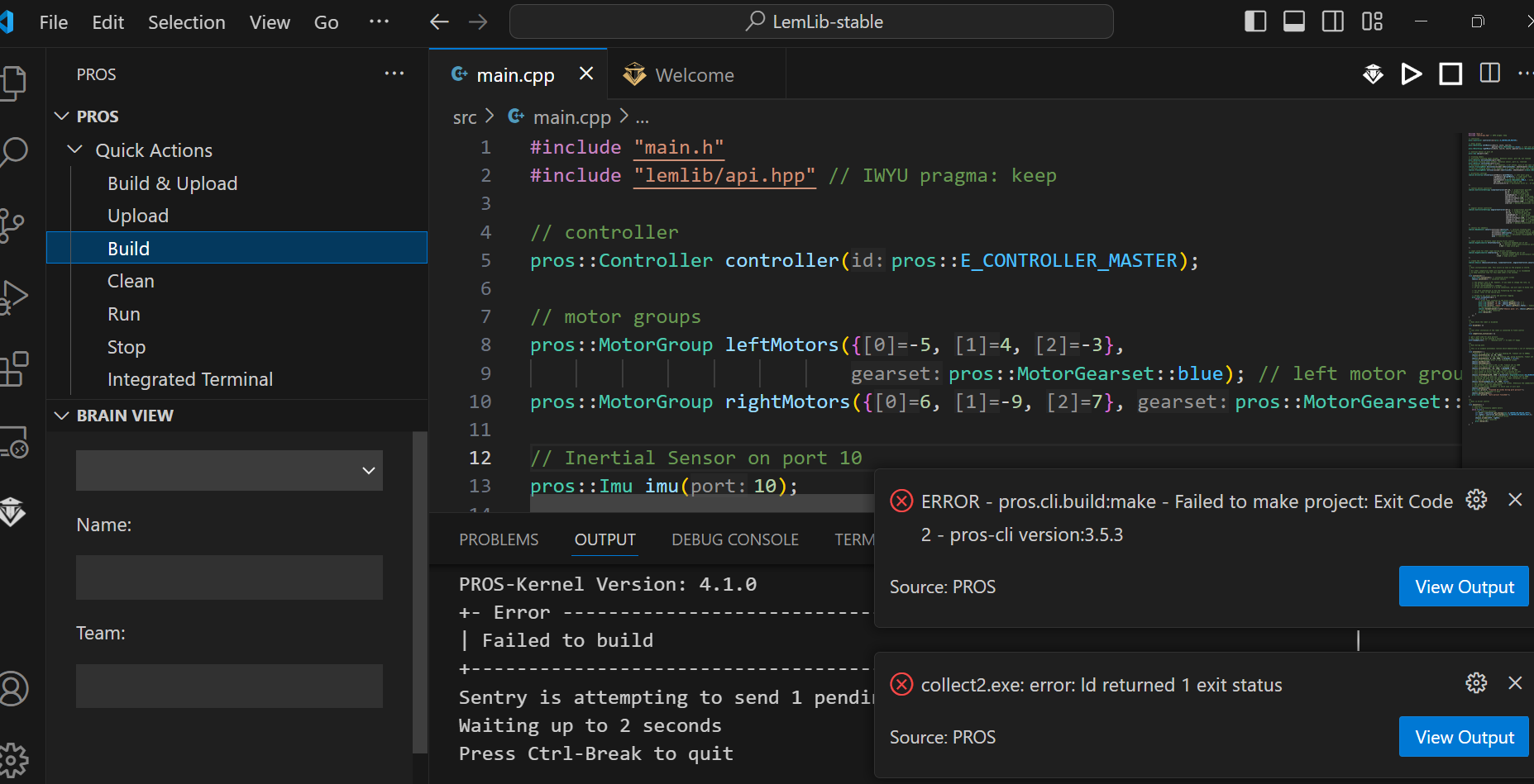

Hi Liam. I started to try Lemlib by following 1 - Getting Started - LemLib documentation. and I downloaded the " [example project] from "LemLib/src/main.cpp at stable · LemLib/LemLib · GitHub. Then I import them into pros, try to build it without change anything, unfortunately, it shows two errors as below screenshot:
. However, if I create a new project then build it, it is successful. So I guess something wrong with the “example project”. Would you please check that?
It compiles fine for me. Can you click “view output” and send the output? Or even better, a zip file or github repo of your code?

You tried to install LemLib into the LemLib source code. You do not need to clone the LemLib repo. The example project is just the main.cpp file in the link you posted.
Create a new pros project, and install LemLib in there. Then copy main.cpp
