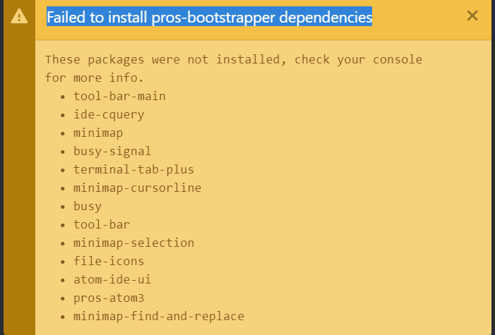

Failed to install pros-bootstrapper dependencies
On starting up pros 3 it says
proserror
can you let me know where these are and how I can get them?
I am a bit of a noob at pros, but are you connected to a good internet connection? My school WIFI sometimes does this so I use a hotspot!
I thought I’d responded to this earlier but I must not have hit send.
The packages listed there are all Atom packages, and can be installed manually by opening the Settings page and navigating to the “Install” tab (you can search for the package names)
