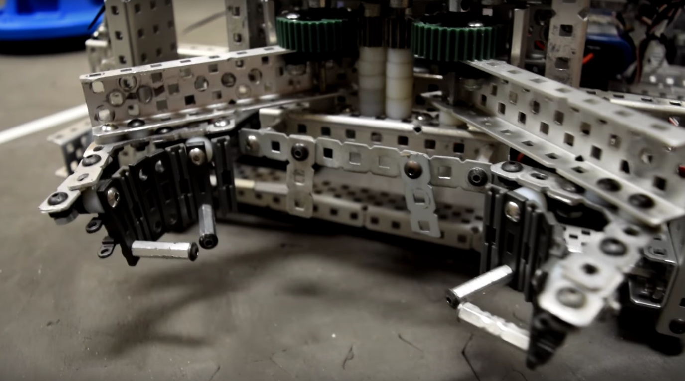

I’ve been looking a lot at how people have built their intakes - and very few had the ability to pick up cones that had fallen. We haven’t been able to really see if this happens a lot. So with your experience in competition or when you are practicing; how often do cones fall and do u think its important in this year’s game? Thanks in advance,

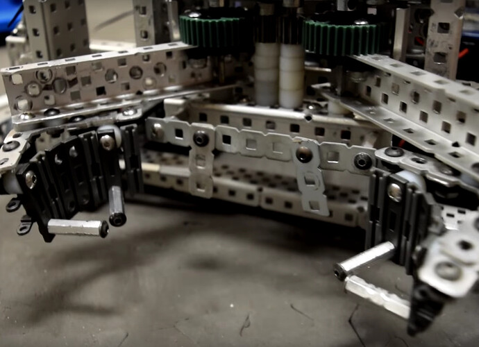

in my opinion fallen cones arent going to be a big issue this season. my team and i noticed that a simple hook attach to our prototype claw works well. the hook placed on the bottom also allows clamp like claws to 1) flip the cone over 2) almost at the same time you should be able to pick up the cone as you flip the cone over
If you look at 1970K’s reveal, you’ll see a hook made of two small one bys at the back of the claw to help pull cones upright. If you’re looking for an easy and passive way to upright cones, this would be a rather good fix. It’s hard to tell whether or not it will be super necessary, but being able to quickly right fallen cones may give you a leg up on some teams.

@popcorn24 and @allalex these are both really interesting ideas. @popcorn24 i don’t really understand how your idea works; could you explain further/ post a pic. thanks,
