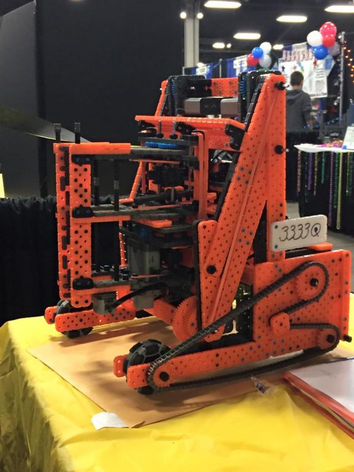

Our Q Team sped up the robot by changing the gear ratio on the drivetrain. The robot had a 24 tooth sprocket on the motor and 16 tooth on the wheels. Increasing speed decreases torque, and we needed to have enough torque to push back a row of blocks. So we tested 32, 48, and 60 tooth sprockets on the motor. Performance started dropping off after 48 teeth.
The other trade-off was control. With a larger sprocket on the motor the movement of the robot was very jerky. The turns were very quick and it was difficult to get a precise turn. The robot was able to get down the row of blocks very quickly, but the driver had trouble setting the stack because the robot would move too far one way or the other.
Robots that were designed to slide along the wall and use the base of the stack to line up the robot would be able to go faster without sacrificing control.
That was our experience, but I’d be interested in hearing what other teams did.
In this picture the sprockets that are attached to the wheels have 16 teeth, the larger sprocket at the top of the chain has 24 teeth and is attached to the motor.
11107179_10153225905588537_6881419465722756986_n.jpg?oh=d823cacd5e56dedb5d52a6219d4e0e3e&oe=55CB78CC.jpg
