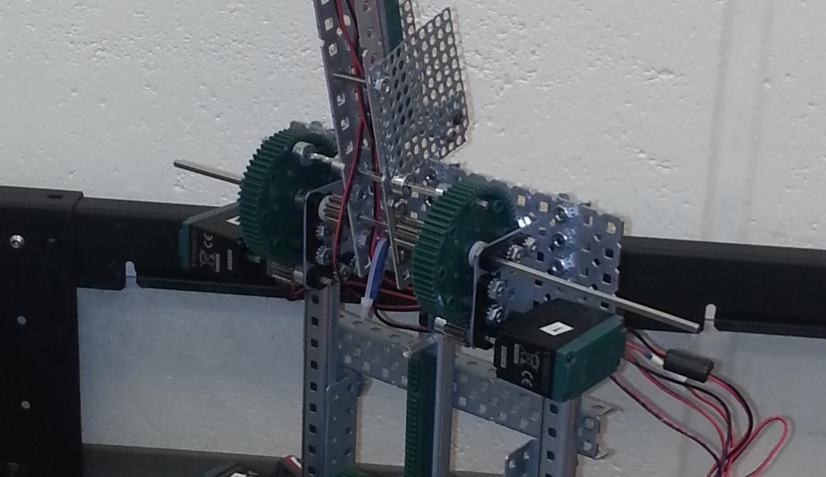

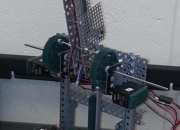

I also like this kind of lift that our club uses a lot
[ATTACH]7947[/ATTACH]
BTW what are the real names for these lifts?
I think the lift you have pictured there is a simple arm. You could call it a 2-bar, I guess, since it has 2 bars (tower and pivoting arm).
