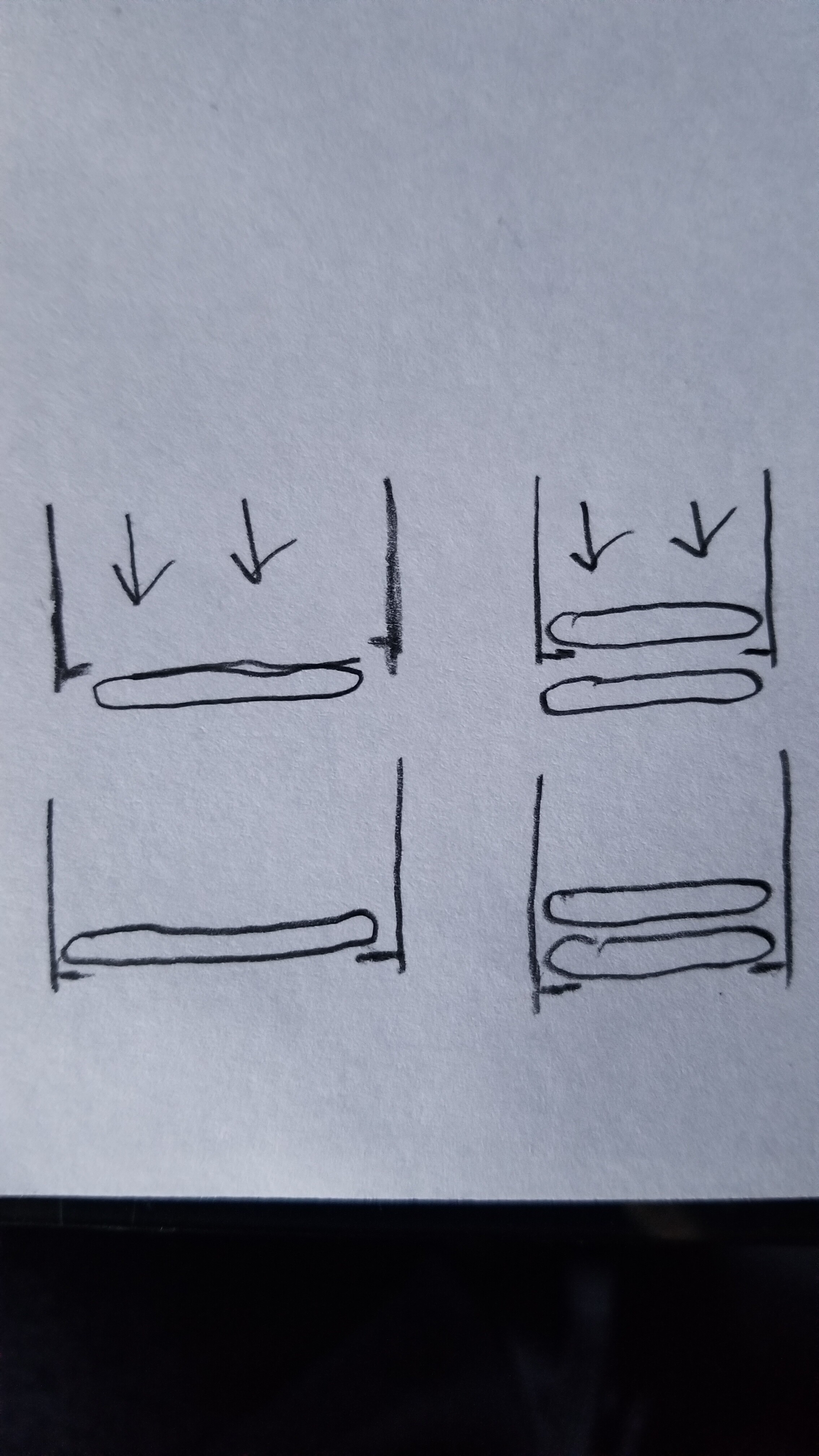

ok so i am having trouble understanding how to feed the discs into the firing mechanism. i want them to stay flat so i can just push them in with a piston but how do i do that?
Depending on how you make the mechanism the disks have a smooth coating and should just slide flat
Ok I was confused on what you were saying at first, depending on your firing mechanism it wouldn’t really matter if you have a motor acting as a servo or a piston pushing directly, or pushing an arm similar to a servo into the mechanisms, its just a matter of what mechanism is fastest and works best.
ya thats what was getting me. i want to lift the discs up vertically into the mechanism. i feel like i didnt give too much context so no worries on not understanding.
i know how im going to shoot them but its how am i going to get them into the robot. i should have just said that. sorry about the confusion
So you’re saying you want an intake that presses the disk into it rather than an intake like a ring intake in tipping point correct?
yes straight up into the mech.
In that case you would probably want a passive claw mechanism that presses the disk with a linear motion, motors and pneumatics should both work. It would look something like this
also the mechanism is also probably going to be what holds the disks in the robot, so to bring it up to the firing mechanism you need to make sure the mechanism is limited accurately. Like an elevator sits in a specific spot for you to exit or enter it.
