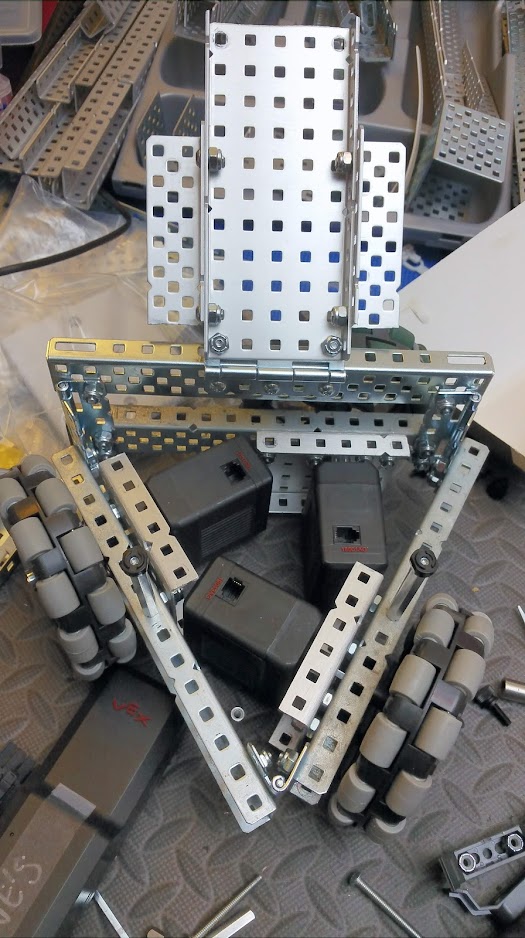

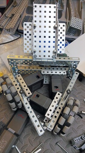

@WillJM here’s the smallest robot I’ve made so far, motivated by supporting holonomic driving practice anywhere.
It was a quick hack, so I imagine a bit more time put into it could make something that behaves itself a bit better. A small clawbot should be an interesting design exercise - the claw could sit between two wheels and you could experiment with chain lifts and four bars and so forth.

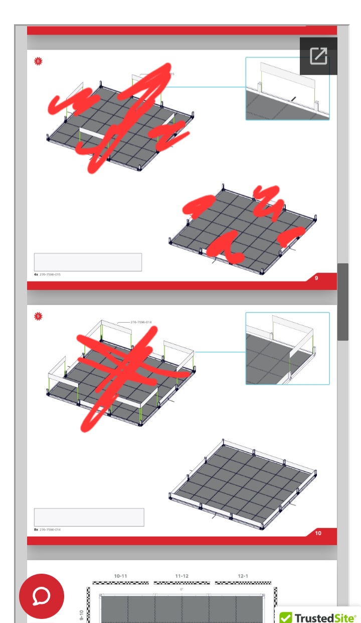

Well, depends what type of field perimeter you have, but each side length of the field uses 3 segments. You can use 2 per side and create an 8x8’ field, cutting out the middle section when assembling the perimeters (your GPS strips won’t work though).
Cut out these sections:
By the way, I tried to look for the non-portable field perimeter, but can’t seem to find it…
