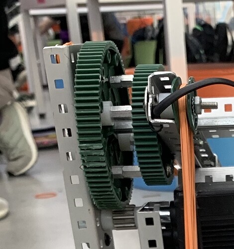

I think we had similar situation earlier.
Since there are spaces between where we placed the 2 bar and the driving gear, there are some spaces in between them, so we used two gears (84 tooth and 60 tooth) to connect the 2 bar and motor. Turns out that the 2 bar is too heavy, and the high strength shafts just slip off the 60t gear, rather than driving it.
We solved it by adding standoffs between the 84 and 60t gear (as shown in the photo). This provided another point to connect / support the 60 and 84 tooth gear.
Hopefully that helps
