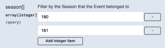

I am attempting to fetch a list of events in the UK for the current VRC and VIQRC seasons. Their IDs are 180 and 181.
This seems possible on the RobotEvents API reference.
Screenshot 2024-02-17 at 23.30.15
I have interpreted “array[integer]” above as [180, 181] in code. As such, I have implemented it as follows in Python:

Hello.
I fiddled around with this issue for a while, and I stumbled upon this anomaly:
When using the “try it out” feature on the Robot Events website, I noticed that the generated URL was different then the one we created (using requests.get()). The Robot Events URL looked like this:
https://www.robotevents.com/api/v2/events?season%5B%5D=180&season%5B%5D=181&region=United%20Kingdom&myEvents=false
And ours looked like this: ( we can see what ours was by accessing the .url member of our response ( as in response.url )
https://www.robotevents.com/api/v2/events?region=United+Kingdom&season=180&season=18
The biggest difference I could see between the two was the absence of the %5B%5D
  • %5B corresponds to [
  • %5D corresponds to ]
Which means we simply need to change the "season" to "season[]"
As in:
This worked perfectly. Thank you very much for the solution and the explanation!
