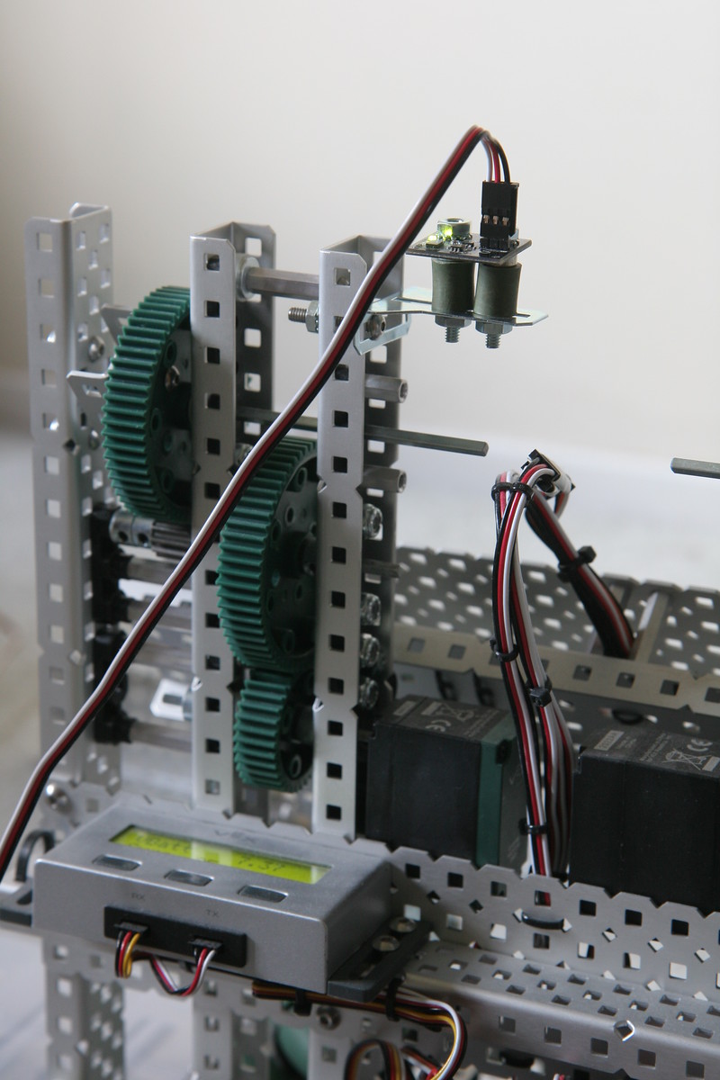

Instead, you should make sure it is in an isolated area away from motors, and the wire should also be routed in a way to avoid interference. This is to help reduce gyro drift.
As @jyao6429 said isolating gyro from vibration is very important:
There are multiple sources of the gyro measurement noise, causing drift. Some of them could be eliminated with this trick:
Finally, software filtering could improve accuracy of the gyro a lot:
