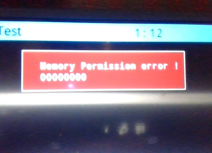

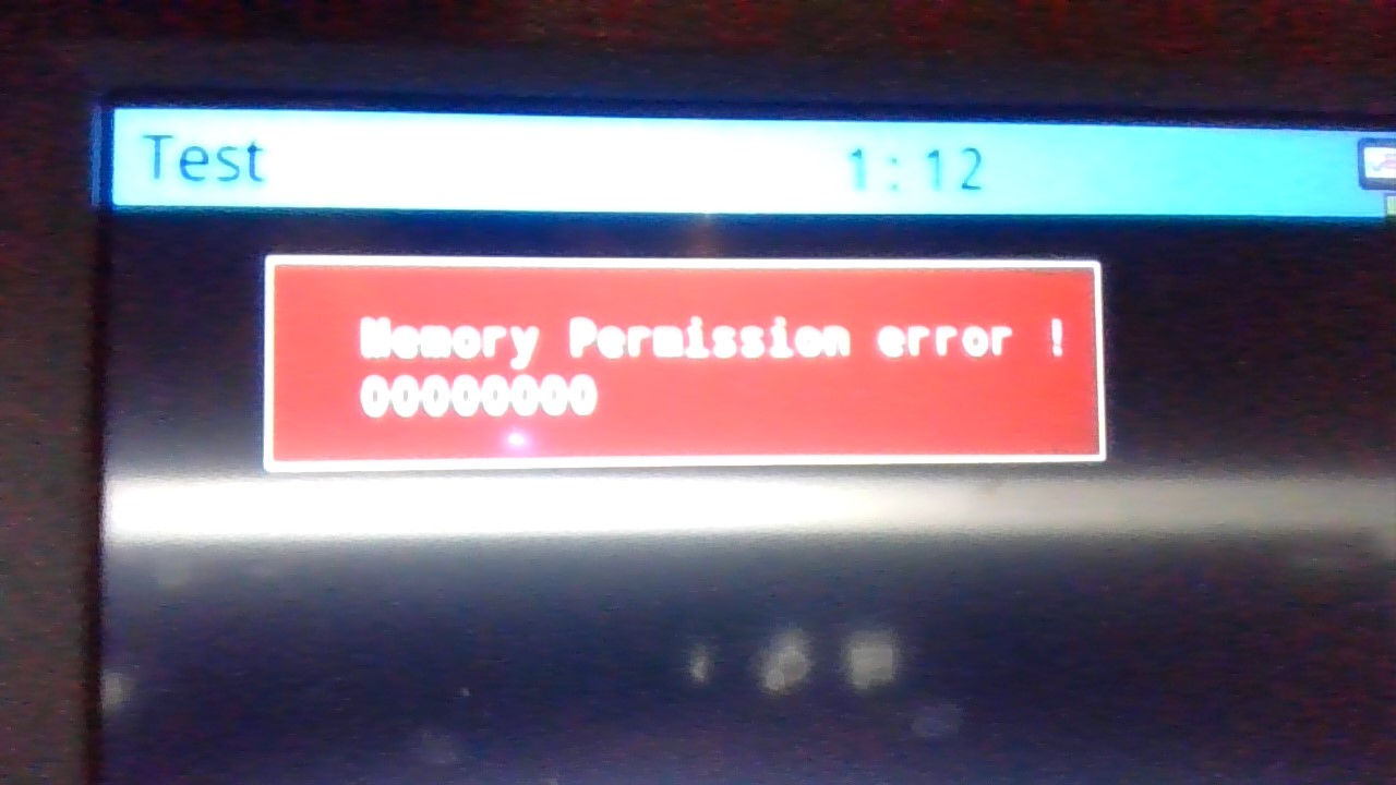

I made those changes and the Brain screen is blank when the program is executed. I also tried to run the littlevGL “hello world” tutorial program in a different project and it gives me a memory permission error.

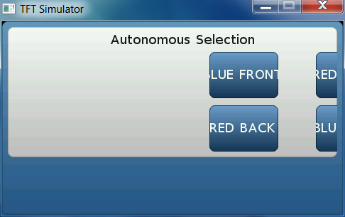

Ok, I only have the PC simulator for testing. My team won’t give up the brain. attached is what i see from the pc simulator.
The other things I did was to remove the “delay()” statements and change string auton=0 to char *auton (no initial assignment); “count” must be declared elsewhere b/c i need to define it as an int.
Thank you so much, I changed the string to char * auton and it is working. If you dont mind could you explain why that fixed my problem?
auton needs to be a pointer so you can reassign its address to each of the string constants’ address.
