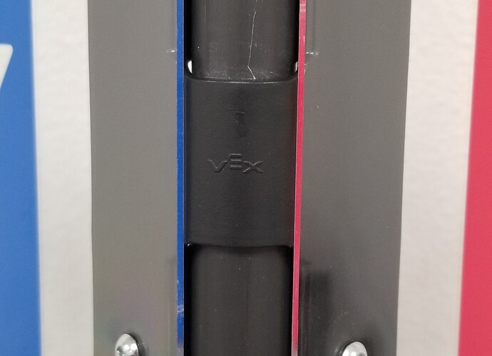

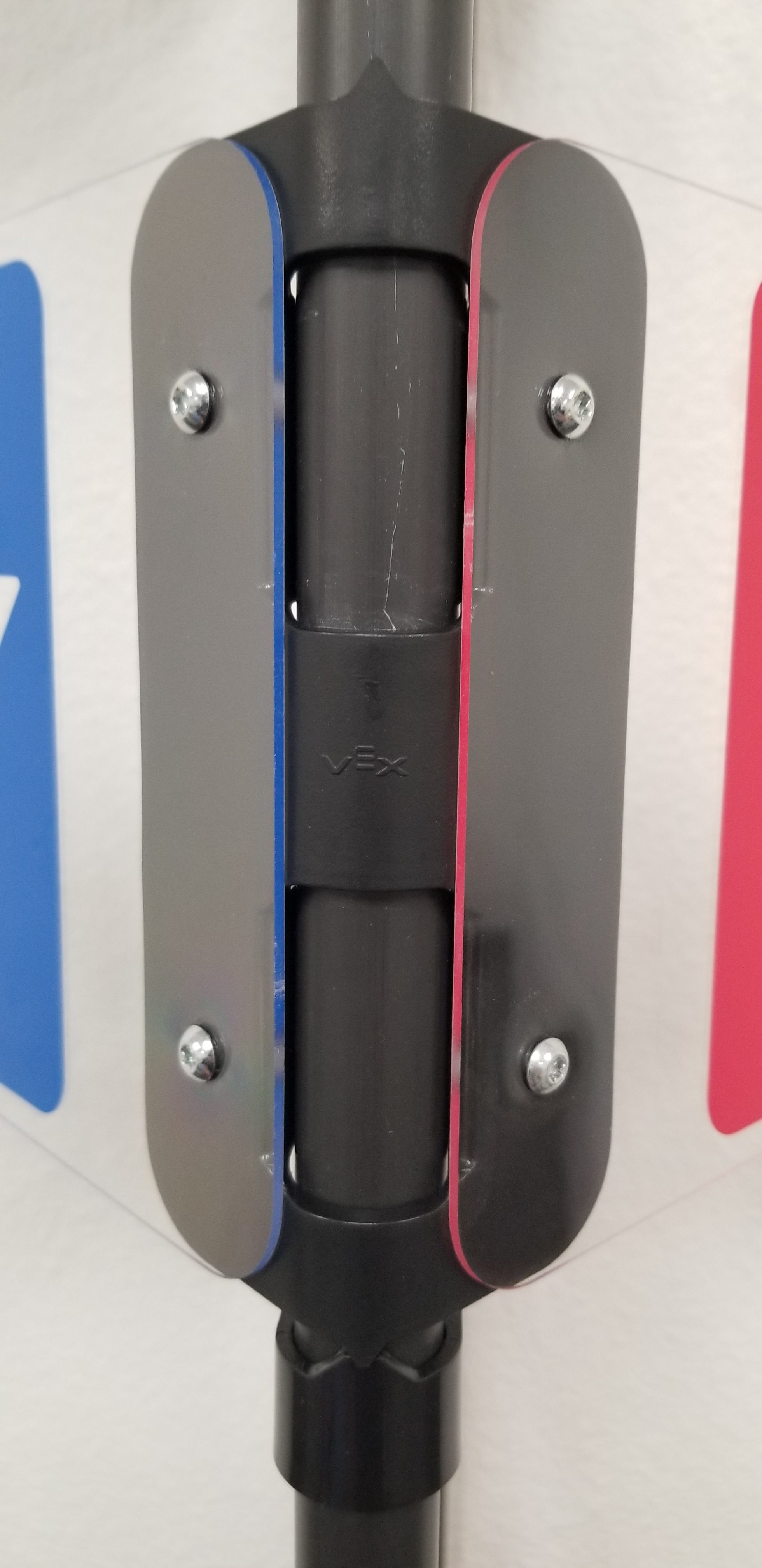

When I first put them together I noticed that the flags have a point to indicate their orientation.
Does anyone think this point will get worn down over the course of the season, possibly making old flags easier to turn than new flags?
I’ve included a photo for those who don’t have their game elements yet.
Let me know what you all think.
A turning point, would you say? :wink:
Now that I see it, that detent pin looks a lot smaller than I originally thought it was. There is a chance that it could break, but I’m not sure that it will accept enough force to break it; it could be sensitive enough to let it ride over instead of bounce back. Have you tested it? How sensitive is it to turning?
My only other concern would be recoil from getting hit by a ball. Someone said that the flags tend to bounce back if they are hit too hard. Can you locate what the flag hits when it rebounds?
@Royal_xD I have not been able to thoroughly test it, but I did notice it takes quite a bit of force to push the pin out of the center orientation.
When flags bounce back they seem to hit the little slope somewhat aggressively.
The pins are plastic so they seem pretty easy to accidentally break/round down.

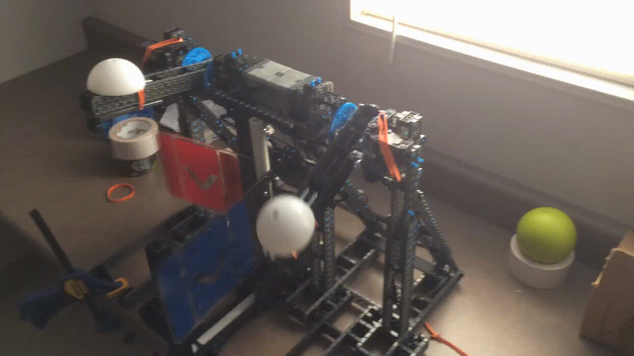

So, this is actually something that we were very concerned about during the game design process as well, as robustness and consistency between events is key for a dynamic field element like this. So, we built a test bed out of VEX IQ parts.
This tester ran for about 3 weeks continuously, stopping only for battery changes, for a total of ~10,000 toggles. The detent and pointer were definitely a bit rounded down at the end of this test, but still functional, and in our testing we have never seen a pointer break or snap off.
It’s tough to estimate how many matches are represented by 10,000 toggles, as it will depend on the competitiveness of teams playing at the event, and this post should not be used as a formal load rating guarantee. But, I would be comfortable in saying that it probably represents at least 15-20 competitive events, probably more.

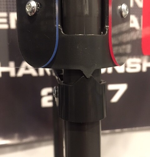

That all said, if you do happen to have a very competitive series of events, or start to see excessive wear, each Flag is reversible - there is a pointer at the top and the bottom, and the bracket with the detent has an additional one on the back as well (see attached image for the reversible pointers). This doubles the lifetime of a given Flag/Detent from (my very rough estimate of) 15-20 events to 30-40 events. EP’s running multiple events can also rotate their Flag positions during setup to distribute the load more evenly, as the bottom row is likely to see more engagement match-to-match than the top two rows.

Very cool to see IQ parts used for this! We still have boxes and boxes of them, and we’ve used them in VRC to test ideas and issues quickly.
That is extremely helpful information. Thanks so much for the all the details. (Plus, I like the IQ robot design).

I noticed the flags and brackets were reversible when I assembled the field, but wasn’t sure why until now.
