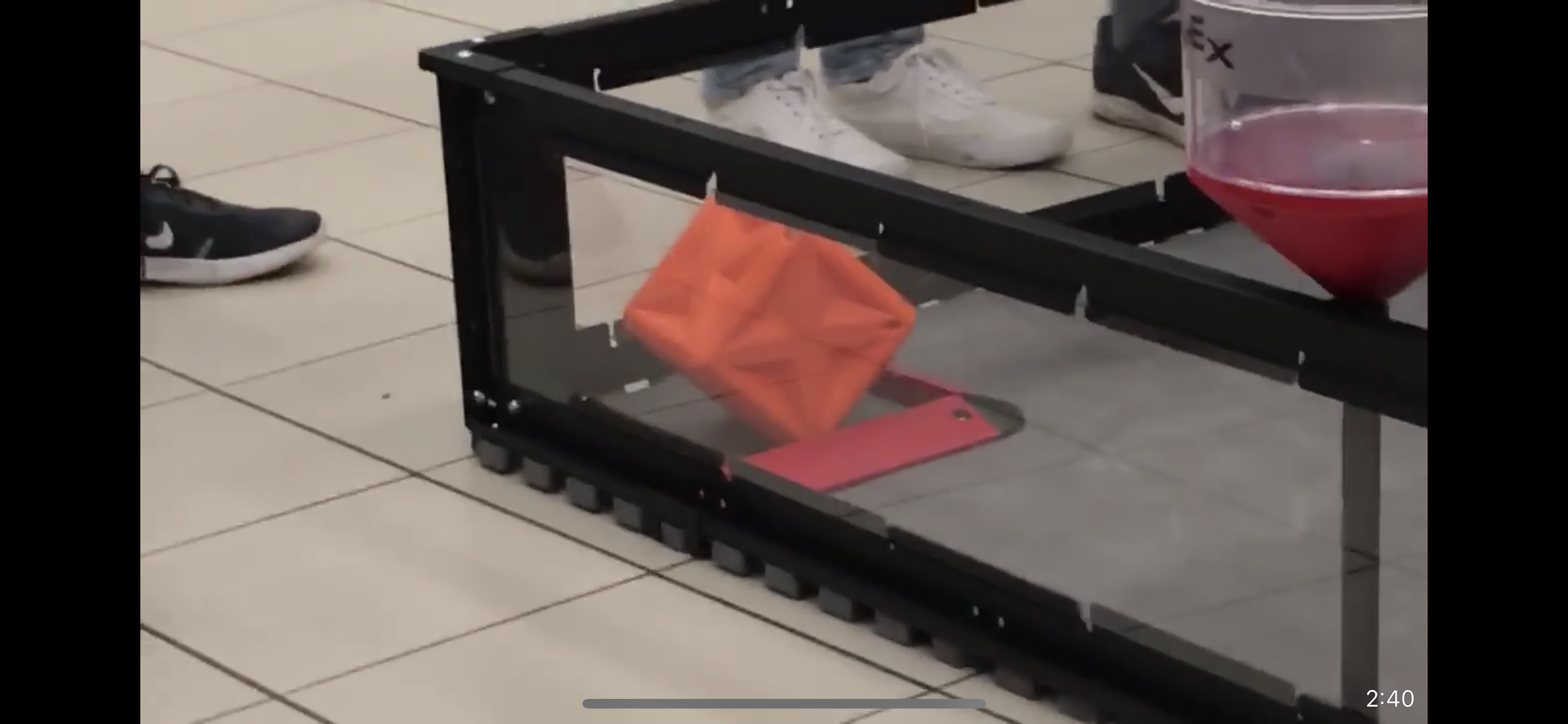

So this happened during auton. I was wondering if this would actually count as scored because it is technically unsupported and flat. image
Was this really match affecting?
Base Cube - A Cube status. A Cube is considered a Base Cube if it meets the following criteria
at the end of the Match:
  1. Contacting the gray foam tile within a Goal Zone.
  2. Level or “flush” with the gray foam tile.
Number 2 means that the cube would have to be resting on its face, so no.

Well, as @mattjiang said, it isn’t resting on it’s face, so no.

The base surface (the biggest area) must be in full contact of foam tile of the base cube,.
Murphy’s Law in full swing, not too sure how that’s possible, but yeah, most refs/teams are going to argue/not count that cube.
unfortunately it doesn’t count. I’ve lost auton twice this season because of that.
For the bottom cube to count it must become a ‘base cube’ which is defined as:
Any cube that is stacked beond the base cube must follow the following definition:
  1. Contacting the Top Surface of a Base Cube or Stacked Cube.
  2. Not contacting the top of the field perimeter wall.
  3. Not contacting the Top Surface of any Cubes which are not Scored.
(Also touching the cubes with your robot makes the cube no longer count)
So basically, no that wouldn’t count since it is not flush with the ground.
