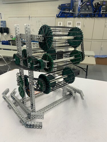

While it may have been a while since Vex: Change Up, if you aren’t able to get the Flex Wheels, this Sprocket-Rubber Band design will work well in their place
Hope this helps
That’s useful for intaking discs, but not so good for energy transfer if you are thinking of launching them with a flywheel.

Elastic band/spocket setups are really optimised for intakes or outtaking without launching.
