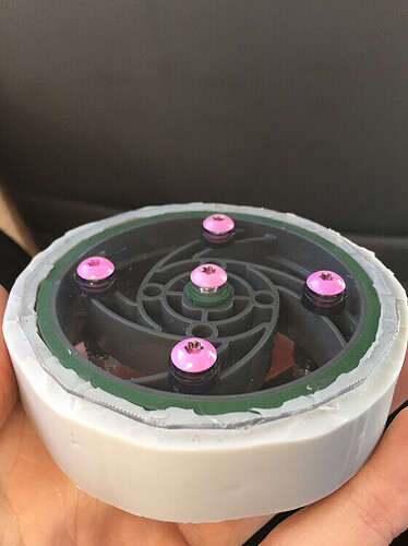

Here’s another method…
this is cursed beyond my comprehension
