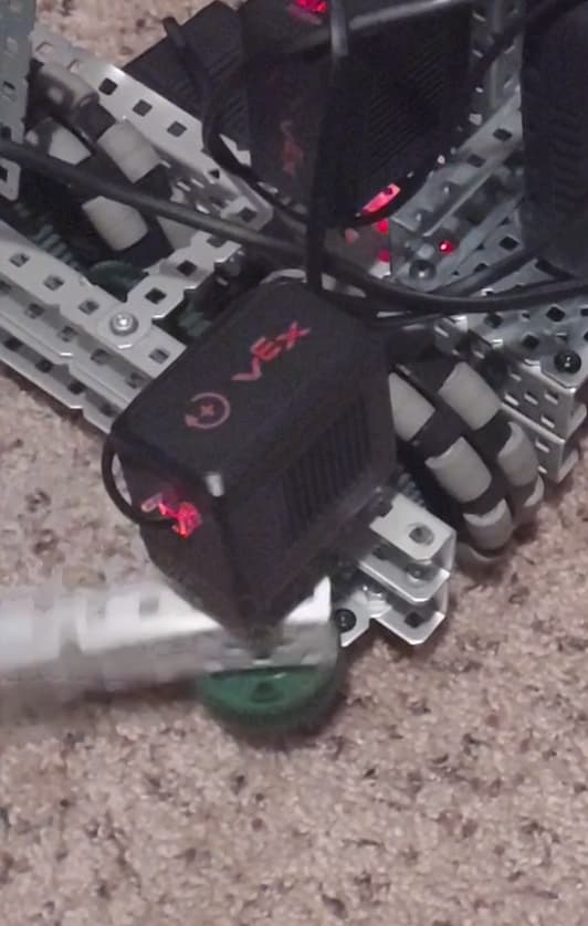

so my team uses motor wings but they are kinda flimsy so when we push the balls we don’'t have the power to push them well

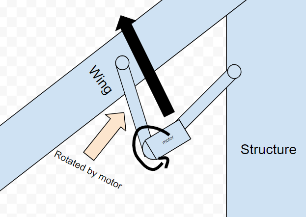

Try to make some mechanism that removes the motor a bit from the force. Here’s an idea (though you’re going to have some wire management issues):

Do you have a video of how the wings and motor operate together?
These are my current wings (There is another forum where I go in depth with how I made them)
If you set your motors to hold, they should hold just fine, at least they do for mine
