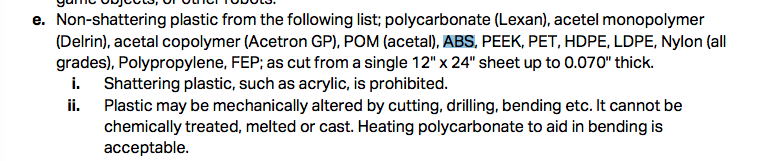

I think that some sort of non-shattering plastic works better than the metal sheets, because they are flexible so when you bend them they create a nice curve, and will return back to the original curve. It’s really hard to bend a piece of metal gradually, and once it’s bent out of shape, its very difficult to get back to the way you liked it before. Personally, our team uses ABS from robosource instead of lexan because it is cheaper, slightly easier to cut, and less prone to scratches after long usage. If you do purchase this, make sure to buy an 11/64" drill bit so that you can drill holes in the ABS which fit the #8-32 vex screws (and axles).
Also, as others have said make sure that the entire hood from start to finish is held with a rigid support to maintain consistent compression on the ball. I suggest you take a look at some robots from Nothing But Net, and pay attention to how they have supported their hoods.
Note: ABS is on the list of allowed plastics if you look in the game manual.
Screen Shot 2018-11-15 at 11.00.52 PM.png (page 36 in the game manual)
