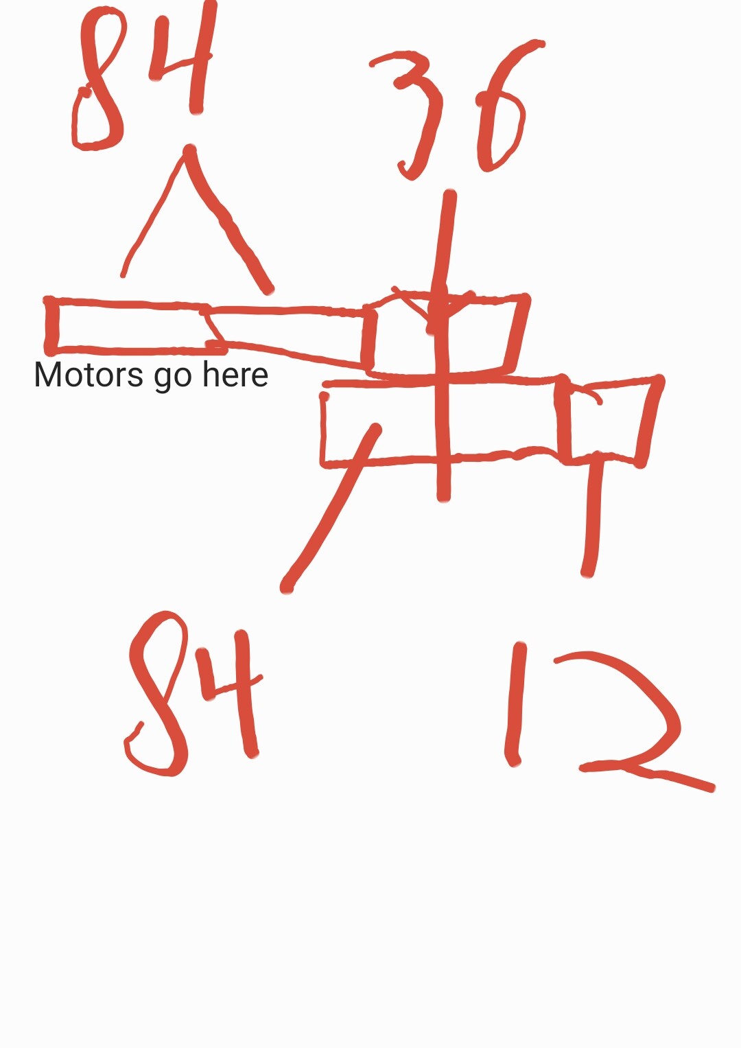

Hi i use a 2 motor flywheel with green cartridges and a 7:1 ratio but its not enough to launch the disk. What is the ideal gear ratio and rpm for a 2 green motor flywheel? (i dont have any blue cartridges) i also don’t have any flex wheels so i use a omni wheel with rubber bands.
If you have a 60t gear on the motor going to a 12t then on that axle a 36t going to the flywheel axle of another 12t, that would put you at 3000rpm which I think is a pretty good speed. I tried 3000 with a turbo and 5:1 and it worked, if you have 2motors it will definitely work
A good ratio on green motors would be a compound gear ratio of 84t gear meshing with a 36t with a 84t on the same axle meshing with a 12t. This gives you about 3200 rpm.

Update: i did the mechanism. you suggested and it works great. Thank you alot!
