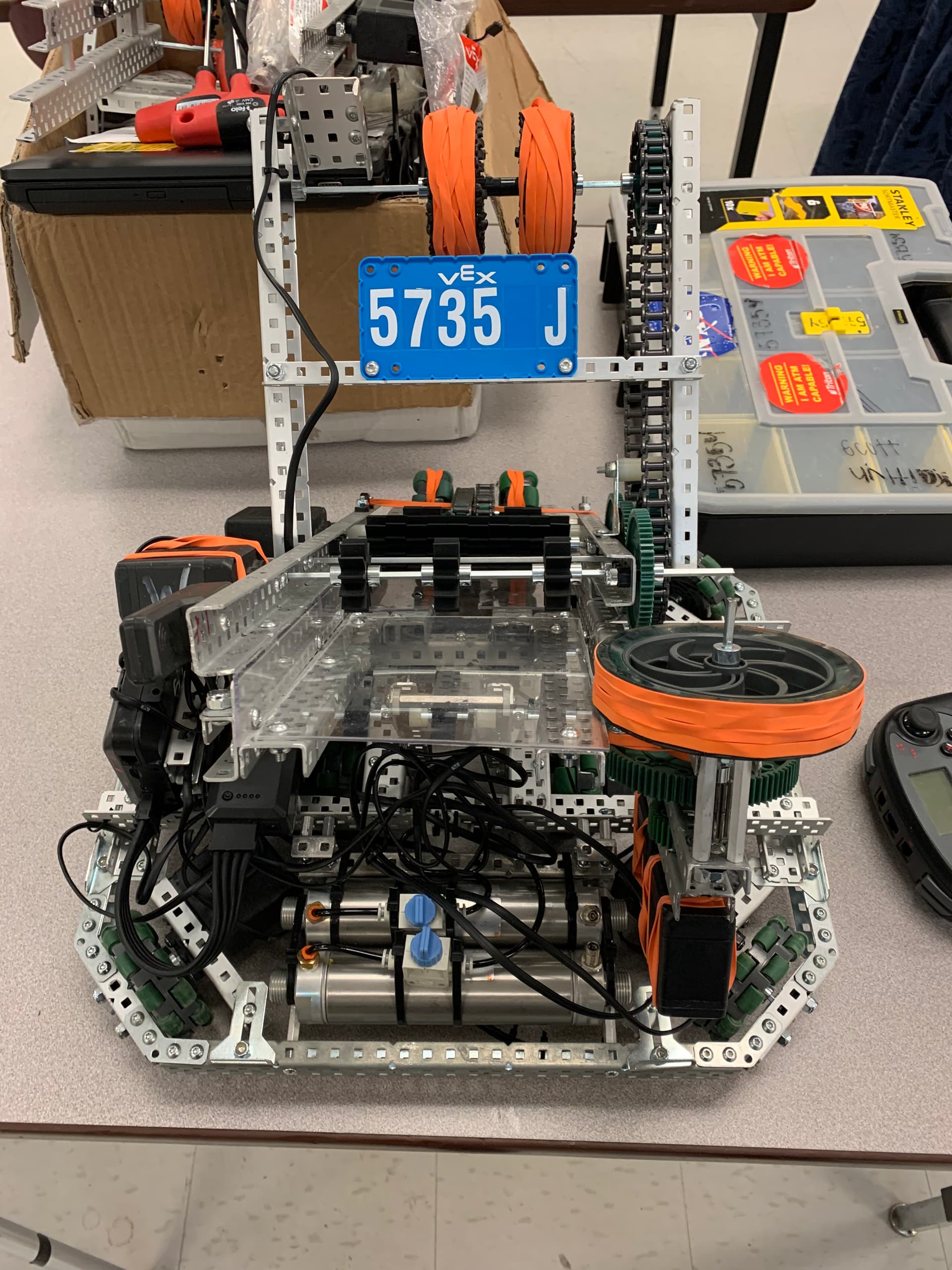

Hello, after a past competition my team has decided to rebuild most of our robot in hopes of improving it from our mistakes and errors. Right now we are trying to decide on how we are going to redo our flywheel. Right now, we have a standard flywheel, that is fed directly from our intake. and shoots out the back of the robot We are wondering if we should keep a design like this, or change it to the roundabout design that has the flywheel spin 180 degrees backwards so it shoots on the same sie the intake is on (I will post pictures of ours and an example of the other variation at the end of this post). What I want to know are the ups and downs of each, and which one is in general better. I also have some questions about how I can make mine more accurate, because during our matches, it would shoot in different directions and at different speeds almost every shot. Thank you, sorry if this is confusing.

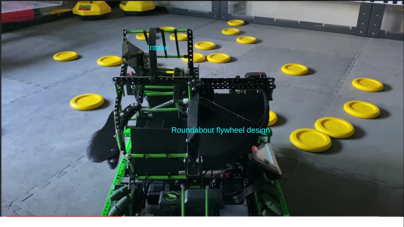

Roundabout flywheel design (not ours):
Our flywheel:
On the second picture of our flywheel: the intake feeds the discs directly into the flywheel, then it shoots out the back, versus the first picture which spins the disc around 180 degrees so that the disc shoots out the front of the robot.

Part of your issue with consistency may be because your flywheel is cantilevered, meaning only supported on one side. Try adding a support to the top of your flywheel shaft and see if that helps.

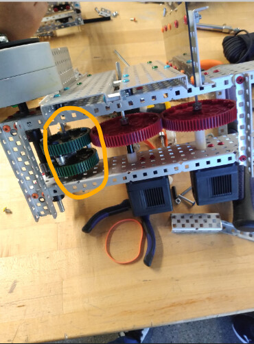

These green gears are your ratcheting mechanism, correct?
Our team has the same type of flywheel drive as yours does, with 2 motors on 84T gears driving a 12T pinion, but I would recommend switching to a more compact ratchet that would eliminate the need for an entire shaft to hold the ratchet.

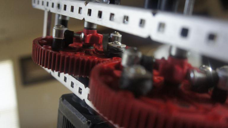

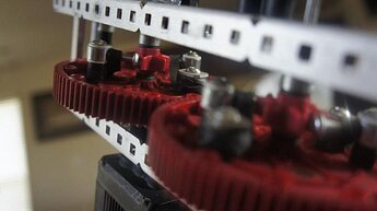

This is the ratchet our team uses:

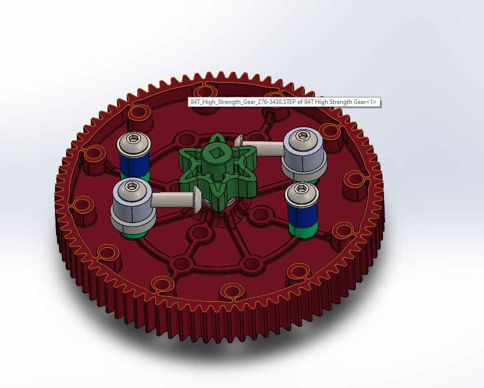

About the ratchet
There is a plastic shaft insert in the gear, which has a circle instead of a square hole for the shaft:
That’s just an example, but using a ratchet that fits onto the gears rather than needing its own shaft would reduce the thickness of your flywheel chassis and give you more space to work with, but more importantly, it would reduce the overall friction because your gear train has fewer shafts to add said friction.

JThomas recommended a 5:1 ratio for the flywheel, and the 84T ratchet will give you a 7:1 ratio. The ratchet design posted by JeterPeter should also work on a 60T gear, giving you the 5:1 ratio you need. The ratchet goes on the same shaft as the motor, making the overall flywheel smaller.
