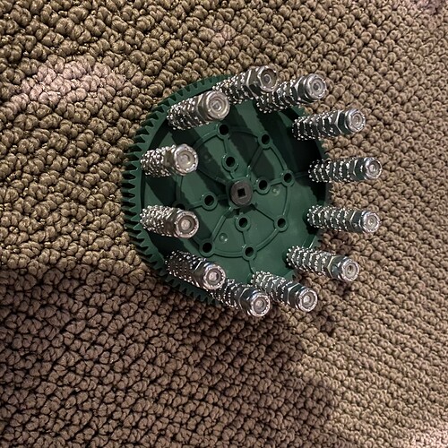

You probably just need more moment of inertia. This thing was more than enough and we needed up taking some weight off of it. I guarantee this will be enough though.

That’s a lot of weight… brings up a possible safety issue. Those bolts will remove skin pretty rapidly if you get a finger in there. Likewise… if one of them comes loose (plastic fails, bolt shears off), you’re going to have a serious projectile. This will throw the whole thing off balance, which could lead to more issues… a cascading failure.
About how much would you say this weighs?
So will any high torque gear train.
Used unlocks at the end and we have never had an issue with them coming off. Been using it for over 3 months.
Not sure as it’s on the bot. The biggest thing is, it’s weight is towards the outside of the bot, so the moment of inertia to mass ratio is height than something like the flywheel weights.
