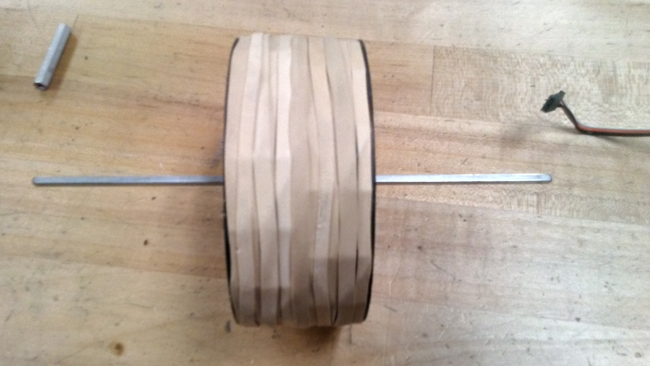

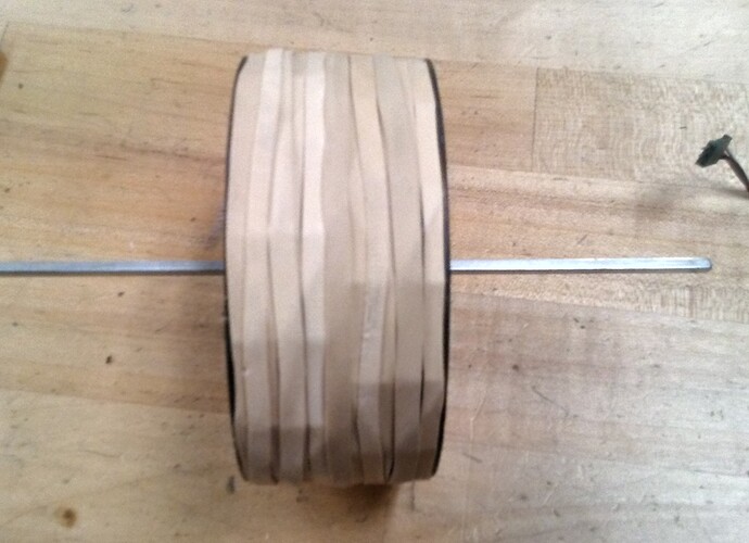

I think you should try single flywheel designs. I will send a picture of a very simplistic flywheel design that can be used in the future :smiley:
I think catapults have been very successful, however one drawback is increased range and altering the trajectory. With a flywheel it is rather easy to change the rpms and go from shooting the middle to top flag or vice versa.

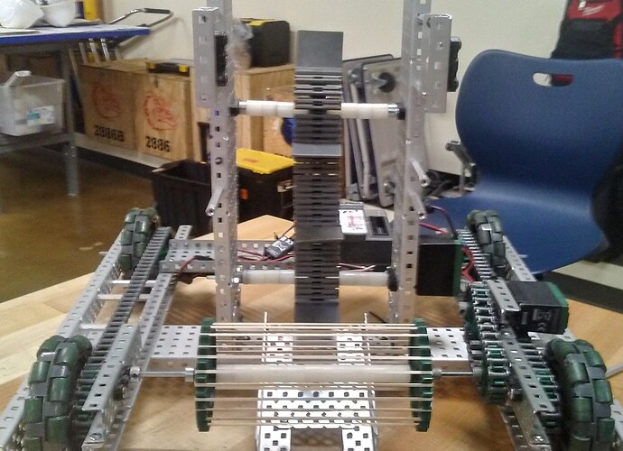

We made the flywheel yesterday. We were gonna attach it to the front of the robot on the small c-channels so that we dont have to turn the robot around to shoot. Would it be better if we just put the flywheel on the back? We ran into problems with having the flywheel on the front.
The first thing I would do is make your gear box then add the flywheel to that, what I usually do is build my gearbox and flywheel housing as one unit then mount it onto my robot.
This is probably a good idea. Just be sure you can mount it really well. I’ve made the mistake of building parts too compact and leaving nowhere to attach them. Just make sure there is as little flex as possible in the system. That is why build quality is so important in flywheels over punchers or even catapults. When something is moving at ~4000 rpm, the smallest flaw is amplified. A wobbly flywheel is no good.
I start with my drive and flywheel and build around that, rather than trying to fit that into whatever I already had build
