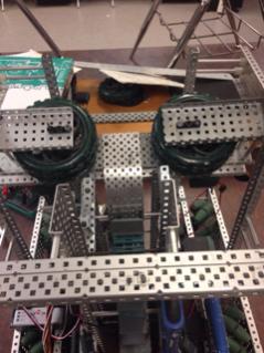

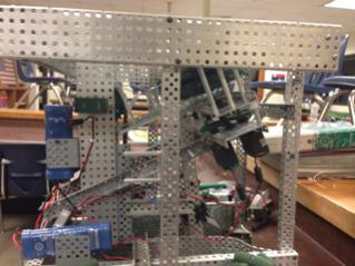

Your launcher should be shooting farther than mine because of the difference in wheel sizes and the ratio. I’m sure the compression is not enough, but you’re having problems with a voltage spike so I’m not sure of how to fix it. Could you post a picture of your launcher tomorrow?
I don’t remember our exact compression, but with just the wheels it barely compressed the balls. We used rubberbands to try to even out the compression. Ill post an old pic from when we were testing where we should have mounted the launcher, so it is a bit of a mess, as you can tell the launcher and intake are not secured and are at an angle in the picture :stuck_out_tongue:

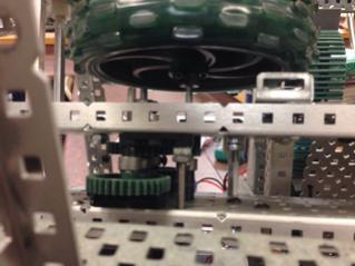

Ok here is our launcher but we are looking into friction now to see how we could reduce it, also in the middle of the wheel where it compresses the most the wheels are 3.5 inches apart.

[ATTACH]9777[/ATTACH][ATTACH]9778[/ATTACH][ATTACH]9779[/ATTACH]
Ok we changed our angle to 30 degrees instead of the 20 degree angle we used to have and we are shooting a lot farther due to a closer horizontal force and vertical force. We changed our motors down to 75-80 and we make it into the goal
