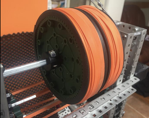

So this year we are trying something weird, we want to use a flywheel for long range shots into the goals. With our current robot we are running a 1800 rpm 4 inch flywheel, and it shoots the balls into the goal about 1 tile away. We want to improve this by quite a lot, by using 3000 rpm. Do you think 1 V5 motor would be able to handle this? I know that some teams used 1 motor 3000 rpm motors for their flywheels in turning point, but change up is a lot different to turning point. The flywheel is made of 2 84 tooth gears, so it’s relatively light. There is some sticky rubber back foam and rubber bands on top.
Here is an image for reference: image
It’s hard to say. Personally given the weight and size of these change up balls I don’t see them getting launched farther than one or two tiles with any precision. I’d say test it yourself and see how it goes. One suggestion I can give is to put more mass on your flywheel. More mass = more momentum so when the ball compresses against the flywheel and gets launched the flywheel decelerates less. Using just two 84 tooth gears might make the flywheel just stall out when it tries to shoot.
The problem is, our motor struggles to maintain that 1800 rpm speed consistently, why aren’t we able to get anywhere the rpm of their flywheels? It struggles at those speeds. It takes roughly 1.5 seconds to rev up the intakes.
you can definitely do it, but you really shouldn’t because your robot will suck at close range cycle speed, and that’s whats really important.

if you use code to slow down a 5000 rpm flywheels to the 600-1000 rpm close range speed, that flywheel won’t have the torque needed to spit out a ball. When you ramp the speed of a motor down with code, you don’t gain torque, you just lose speed. (you lose a bit of torque too I think, but mostly its a speed loss)

In the end use a heavy enough fly wheel to keep a constant ish output when launching the ball and a high enough rpm to launch the ball fat. The faster the more motors you need to dedicate to it.
