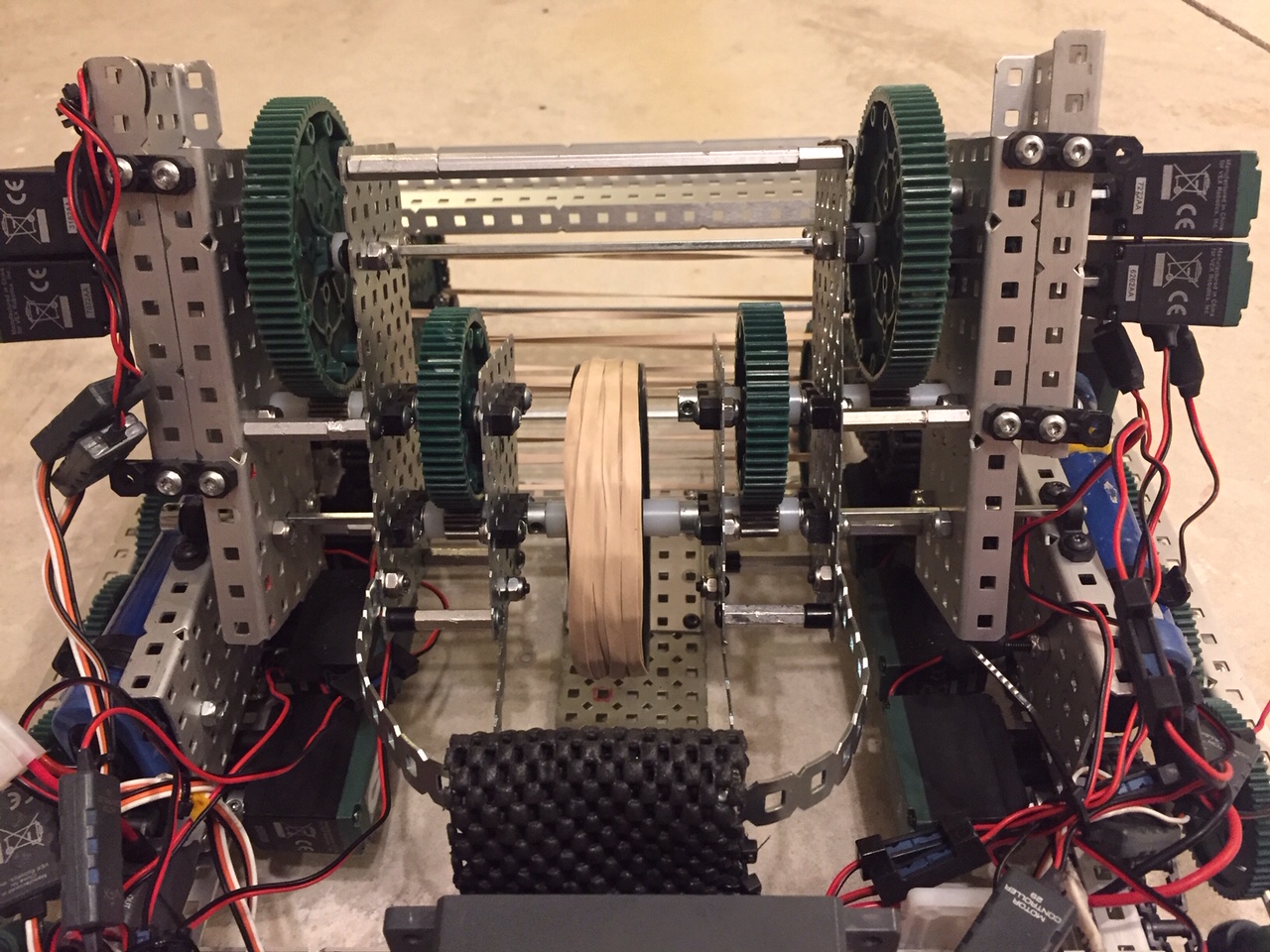

We built a flywheel that runs on 4 393 motors and is geared a total of 1:35 (seems fast enough based on what I have read so far). Our issue comes in that when we run the flywheel, the motors seem to stall out after 6-10 seconds. Any suggestions?

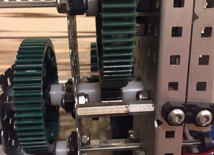

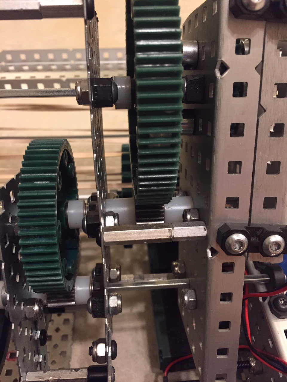

You are tripping the power expander in the videos it looks like. Watch the led on it. And the gearbox on the right looks like the 5x1 c channels aren’t lined up straight, which is probably causing excess friction before the 84 tooth gear.
