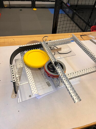

Sooo me and my first ever competition for our school and it was fun but we have quite a few problems. One being our flywheel. We took our cartridge out and just programmed 3 buttons (y, x, a) to be at 50%, 75%, and 90% power but the 50 was to low and the 75 would overshoot. My knowledge on gear ratios is very questionable. Any suggestions to get the right power for it?

We have no way to be sure, but we definitely have some friction problems. I am trying to get ball bearings to fix this.
Keep in mind that ours is actually faster than 3000 rpm, but not enough to make a difference of 14 feet. I would suggest that you probably aren’t actually reaching 3000 rpm. It’s possible that it’s never reaching the geared ratio due to the motor’s torque limit. We are using a cartridge-less flywheel to actually be able to reach full speed (it eliminates friction from the gearing, thus allowing us to have a one-motor flywheel and a higher top speed). You can see the actual velocity that it reaches, the power usage, fluctuation, and other useful stuff from the brain screen’s ā€˜devices’ menu. Note: it’s probably better to have a more powerful flywheel that you run slower (we run ours around 20% normally) than a flywheel that has the same top speed as your total intended speed.

Check your bearings. Turn the shafts by hand. Do they feel ā€˜notchy’? If so, your bearings are damaged.
Check your shafts, they should be smooth when turned. They might need a light sanding.
Check shaft alignment… turn on the motor using direct brain control. Spin to ~50% speed. Check watts used. Slightly loosen screws holding flywheel assembly together. Wiggle left/right/up/down until watts reads the LOWEST setting and then tighten screws to hold it in that position.

We found it is fairly important to tweak fit between the flywheel and the side of the chute when the disc makes contact with the flywheel. If the fit is too loose the flywheel can’t impart much energy. I think we found the width between the flywheel and the side should be between 1/16ā€-1/8ā€ narrower than the disc itself.

From this picture (HW based design) you can see the space between the flywheel and a strip of poly is too big. We adjust the spacing by moving/sizing the strip.
