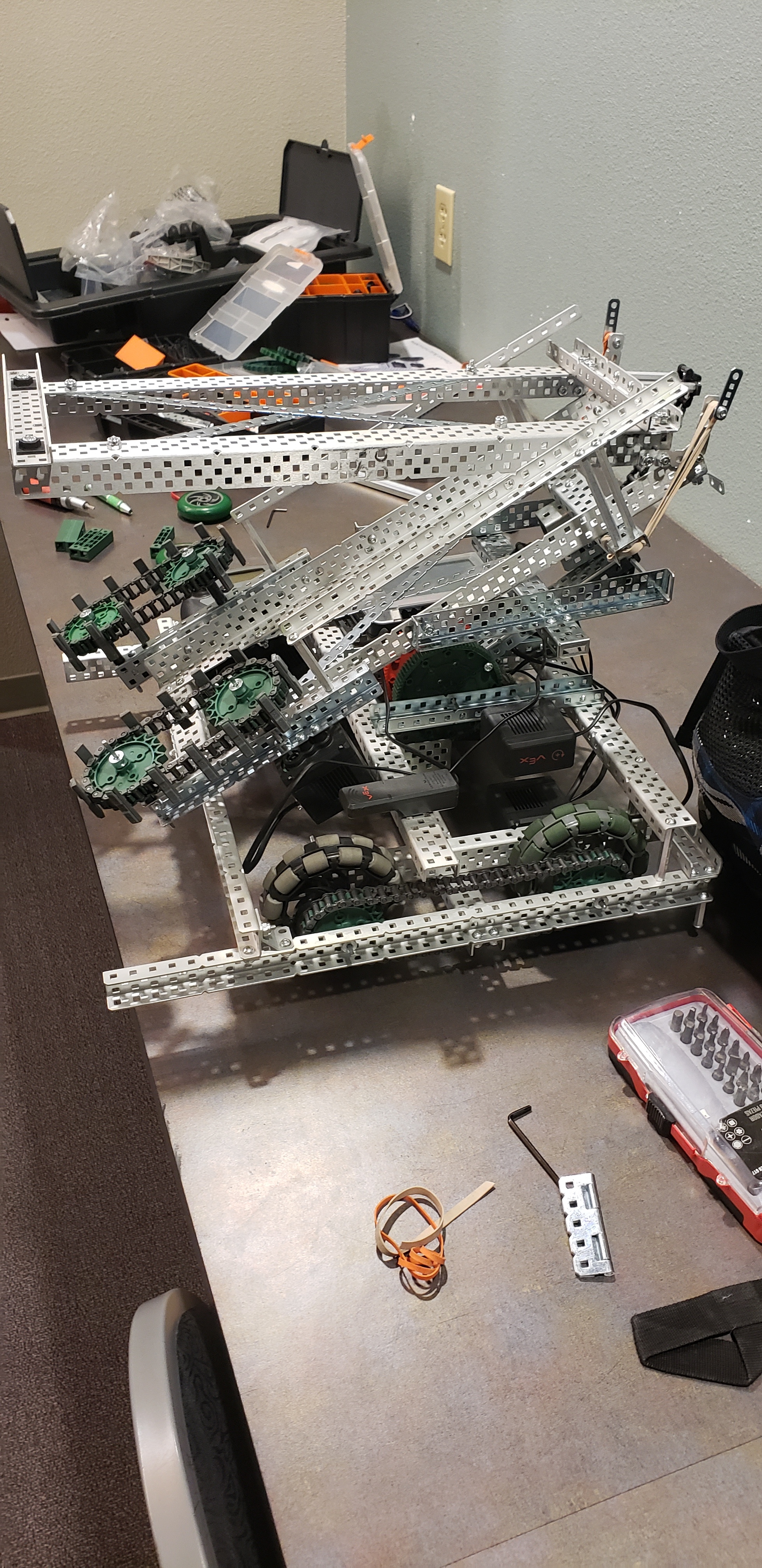

Me and my team are having an issue with our plate to flip open, we are looking to see if anyone can help us to get the stages fully compact and within 18" 18" 18"
Could you share pictures and sizes?
15736873264128029926217496097610
15736873423684698117155182780405
What is stopping your tray from closing all the way?
Also I would advise cutting down the excess c channel sticking out the front as that could stop you from placing in corners

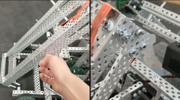

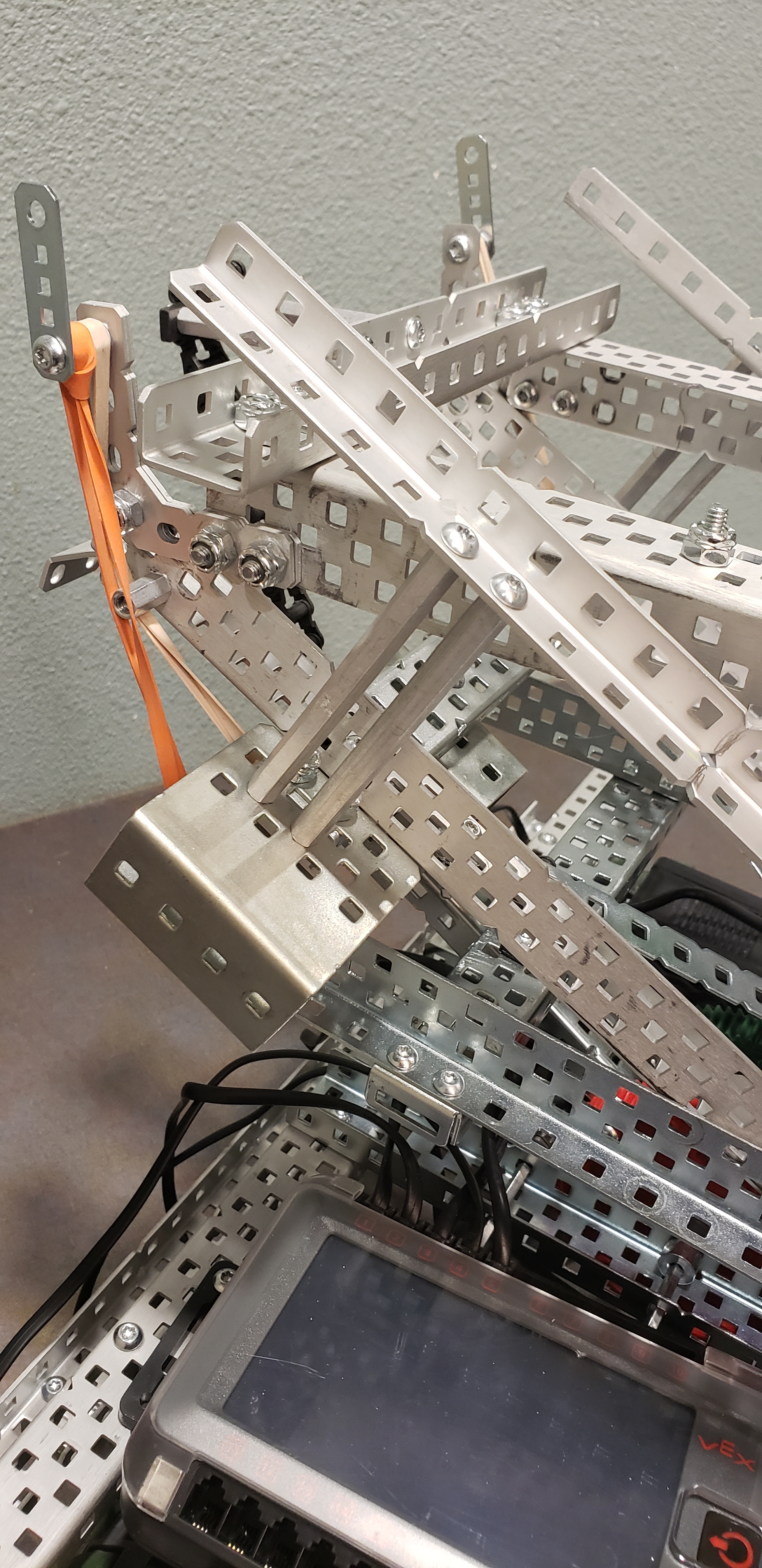

Close up pics of the hinge would be nice. Around your issue.
The two stages are hitting each other

It doesnt look like the tray moves at all. That being said, your hinge could be adjusted to something like thisScreenshot_20191113-163038_YouTube
Probably cut the excess c channel sticking out the sides of the 2nd stage
We dont have any excess we have railings on the standoffs, but I will try to change the hinge.
