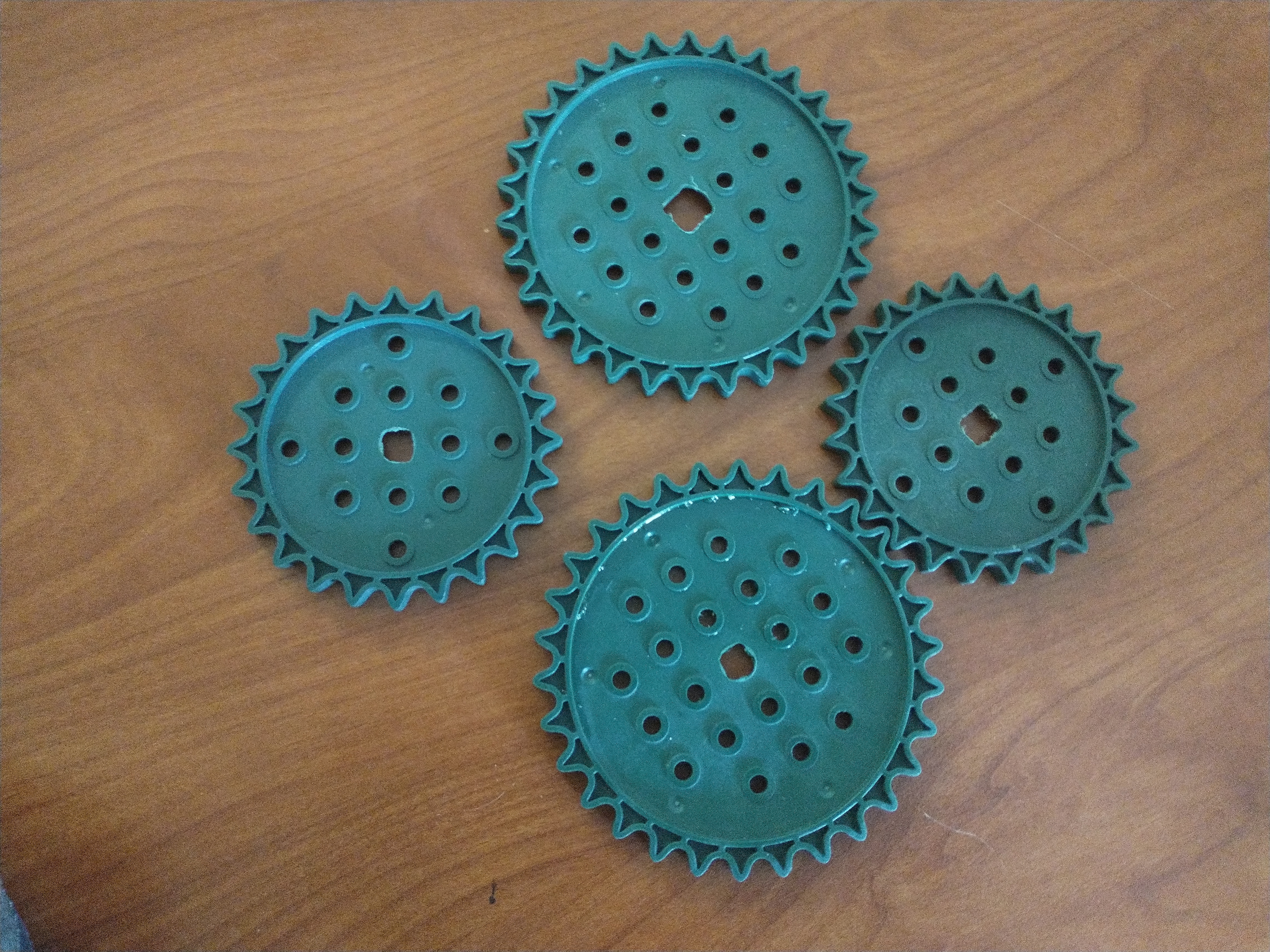

You can make them in non-circular shapes for some really interesting applications.
You can shape them to “linearalize” the load on the motor for the lifts, in addition to gravity assisting rubber bands.
Or, conversely, you can increase force or speed in certain parts of continuous cycle:
https://www.sciencedirect.com/science/article/abs/pii/S0094114X12001462
For example, you can have front intakes with “Strong” and “Fast” sides that will mostly run fast but will be able to push trough objects with force if necessary.
