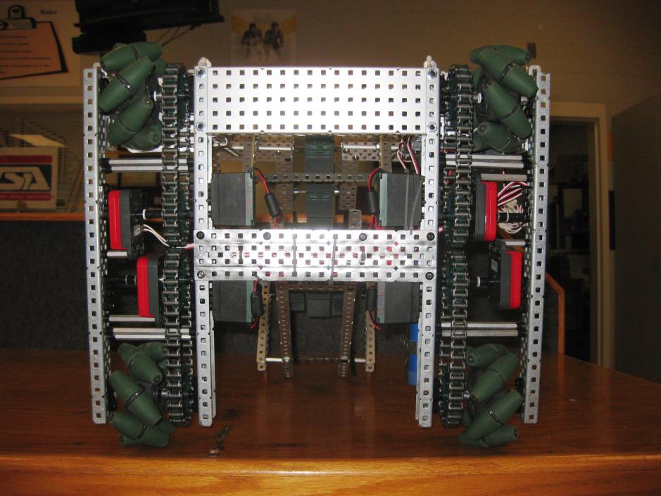

4-wheel on Pillow Blocks is the best way to traverse the bump this year. You can’t get stuck, balance doesn’t matter and it’s easy to build. Mecanum and Omnis both work. I think we’ve done… 8 chassis this year. I really like Pillow Blocked 2:1 Mecanum, personally, but you have to give that a running start at the bump because you loose acceleration. 1.6:1 is fine, and the much safer option.

We’re going with 4 wheels mainly due to access with mecanum drive.
High traction and mobility caught our eye initially. It adds a bit more control in the driver period, but it also adds flexibility to autonomous. After prototyping, we found out it went over the bump like it doesn’t exist, so we had no reason to resort to a 6 wheel drive. We also got over the programming barrier pretty early into the season, so that wasn’t a handicap.
True, it’s an elevated drive, but due to our chain bar, our center of gravity isn’t as high as scissor lifts or linkage systems anyways. We never worried about tipping from the side because our drive train is wide and gravity’s centered. We never worried from tipping from the front because our lift would be there to right us. With poor driver control, we could tip from the back, but our chainbar also has the ability to right ourselves and continue playing. We added a rollguard to prevent tipping from the back, but we still need to test it.

We have four wheels with the chain wrapped so there’s an open space between them. Each wheel is mounted on its own bracket so we can literally un-bolt the bump from the field and slide it under the bot between the two wheels with no contact.

I agree in a match it has it’s downfalls, but I think the pros over-weigh the cons. Even if you are being pushed sideways, you can turn and push against them, or let them push you into a solid object and wait for the pinning count to start :smiley: (first option is best). This drive train gets over the bump like a pro. We can get over in less than a 1.5 sec. It also straddles and un-straddles the bump very well. The 6-Wheel drive just takes way to long.

We tried this in Gateway, and it has some major disadvantages. When a team tries to push you sideways, it turns your wheels forwards and backwards. This means that if you try to drive straight as you are being pushed, it may stall your motors. And it’s “mecanum wheels.” :stuck_out_tongue: Hooray for Google spell check (search).
