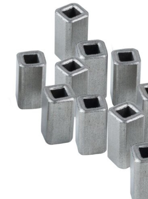

Free Spinning Insert for the Metal 12 Tooth Pinion Gear
As of now, I haven’t been able to find or make a free spinning shaft insert for the 12T pinion, like exist for the 36, 64, and 84 tooth varieties.
I would greatly appreciate it if there were a version of this part:
That had a circular middle instead of a square one, and it would be incredibly helpful, especially when making ratchets and other complex mechanisms.
Totally agree. However, if you’re in need of function, and not a new product, you can either shave down the corners of a green circular insert (so it fits) or drill out the hole in a metal or plastic 12-tooth gear.
I only have a few, and I’d rather not damage my parts. I see that that would work, but I’d rather have a specialized part for this specifically.
I don’t have any pics, but my club has some 12t metal pinions that don’t need inserts, it’s just the smaller axle size. Some are square holes and some are circular.
I have some of these too
All of mine are square.
They likely just had a member drill them and the club doesn’t remember. They were never sold with circular holes.
