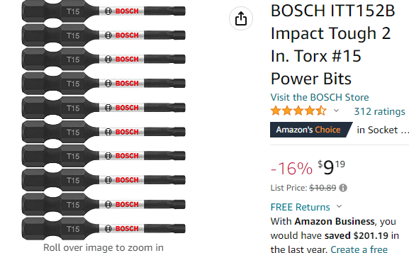

Cordless screwdriver and nutdriver. Buy them. Extra long tips that will go through a 1x3 c-channel. They exist.
Where do you get them?
If you properly tighten your keps, they should never come apart. I’ve been running mostly keps on my bots for the entire season and the few times where I’ve had a keps fall off or come loose on my bot was because I didn’t tighten it enough. A wrench and screwdriver will suffice. If it doesn’t, do some push-ups.
Budget brand driver… main thing is torque control to you don’t overtighten things.
These are good, but only go through 1x2.
These are 3" long, should go through 1x3 easily. You might have to spin them in the driver and sand down the tip just a little. Worth every penny.
