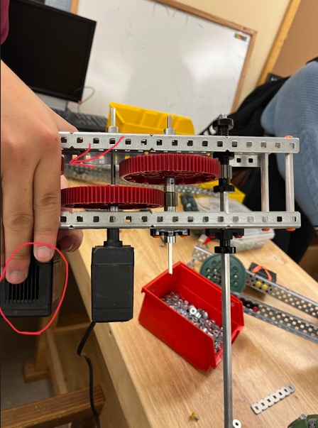

Friction problem
Suggestions to reduce gearbox friction?? Need help in order for flywheel to actually run smoothly.
Make sure that the hole the high strength axel is coming out of is big enough that the axel doesn’t rub in the hole. If you have the ball bearings, use them, and if you have a blue motor cartridge, use that instead and decrease the ratio
(Edit: also make sure there isn’t a lot of metal on metal contact especially with that second axel, it looks like there might be some rubbing there)

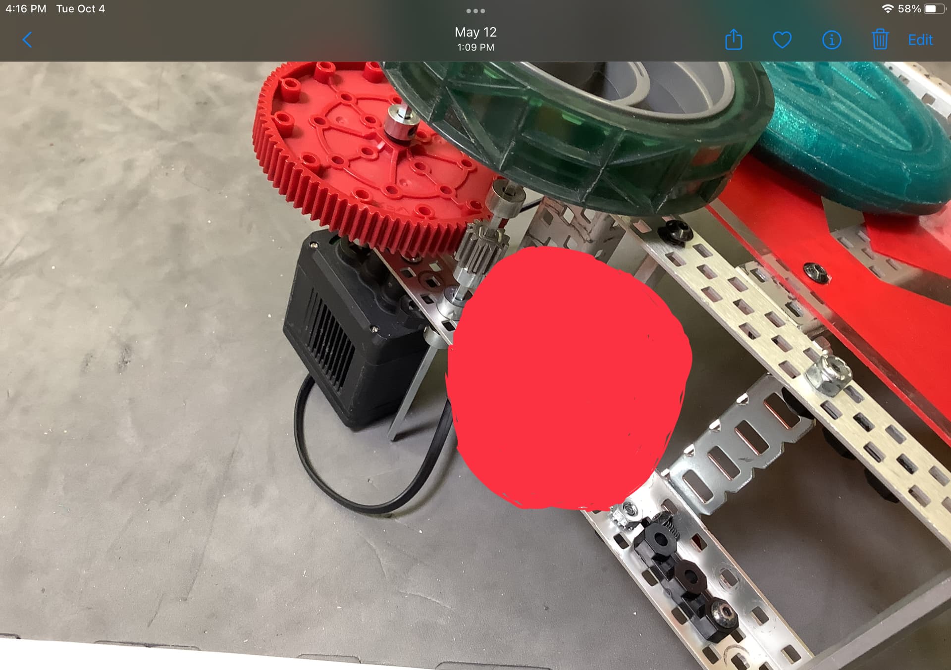

Seems to me like one motor is trying to spin the other at a different speed (there is a different gear ratio between the 2 motors:
Washers or spacers between metal and metal.
I agree with @Some_random_person, it doesn’t look like a friction problem so much as it does a gearing problem. You have 84 to 12 to 84 to 12, where you should have 84 to 84 to 12. Or something like this (minus jank)
HS shafts usually have a very high amount of friction. I would highly recommend using LS shafts for your flywheels and/or using ball bearings.
if you are using a 200 rpm cart, your flywheel is spinning at 9800 rpm. That is crazy fast and your motor will not be able to run that well. Also, is that a second flywheel motor?

Try and see if you can find a gear ratio that will spin the flywheel with about 3000-4000 rpm. That seems to be a good speed for most teams.

Also check out using a no-cartridge motor. It spins at a max of 3600 rpm
Super lube would help, but like others are saying your gear ratio is too fast to be effective. I would recommend something around the 3000-4000 rpm range for a well balanced flywheel. Good luck!
A few ideas; drill out all axle holes, make sure pillow blocks and c channel are centered together; or try a gearbox-less motor 606x has a great you tube video explaining how this works.

general rule of thumb, “less friction = less load on motor” try to reduce as much friction as possible. a good way to test this is to spin the shaft by hand and if the shaft spins nicely, which you will definitely be able to tell if it is, that means there is not that much friction on the shaft. you can also loosen up the bearings (black things with the three holes) and wiggle everything around till it spins nicely, then tighten everything back up.
