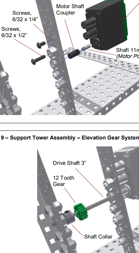

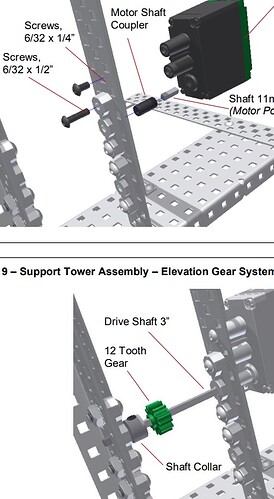

Sometimes longer axles may be necessary when constructing gearboxes. But longer axles are prone to bending and you could end up with extra friction even if your 3 bearings are perfectly aligned.
Also, it may be desirable to avoid putting additional side loads on the internal motor gears.
To help in such circumstances it is recommended to use shaft couplers to join shorter axles and allow some flexibility, while still transmitting full torque.
Here is an example of such use from a PLTW tutorial:
