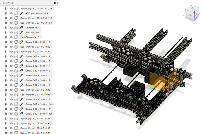

I recently have bee designing a drivetrain on Fusion 360 using a CAD library (there only really is one right?) and I’ve come across an issue when mirroring. As you might have experienced yourself, when mirroring objects the sketchpoints and blah blah go missing, so each component is at its max length rather than mirroring exactly. Does anyone have a solution to this?
Here’s an image:

Try breaking the links on all the parts you want to mirror, that may also help some- will allow you to edit those as a separate part without it thinking that it is the same as the part in the library, per my understanding
