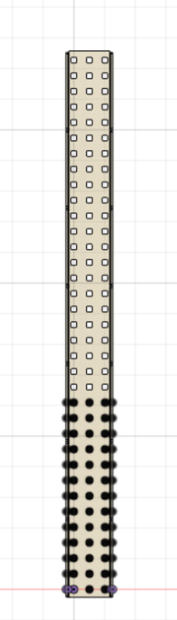

Dear all,
When I use the VEX Cad library and the add-in and modify the length of a 3x aluminium C Channel, a bug occurs as attached below. (Only the black dots in each hole are removed, but not the metal)
However, other parts like the 5x aluminium C channel, 5x aluminium plate, and more can be modified normally. Is this some bug or is there something that I might have missed? Many thanks.

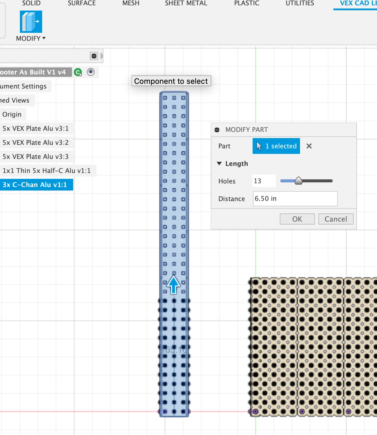

Try reading the faq on GitHub. It helped me a lot when I had this problem.
This problem exists with both the 3 wide channel and the U channel.
Hi, it would be great if you could change the tag on this thread as the VEX CAD project is not run by Vex.
I assume you recently downloaded the parts and tool from here:
I just tested it and could not recreate the problem. Just to confirm, are you selecting the Component and not the Bodies?
EDIT: Listen to what Benn said, I posted this at the same time and that would work better.

Are you trying to cut the piece. if thats the case i just make a sketch and extrude it into the Cchannel and cut it that way.

I selected the bodies - let me try to select the components . Many thanks for your kind help!

Thanks so much @Benn and @Max_Johnson03 for your quick help! ‘Unsupressing Features’ solved the problem!
