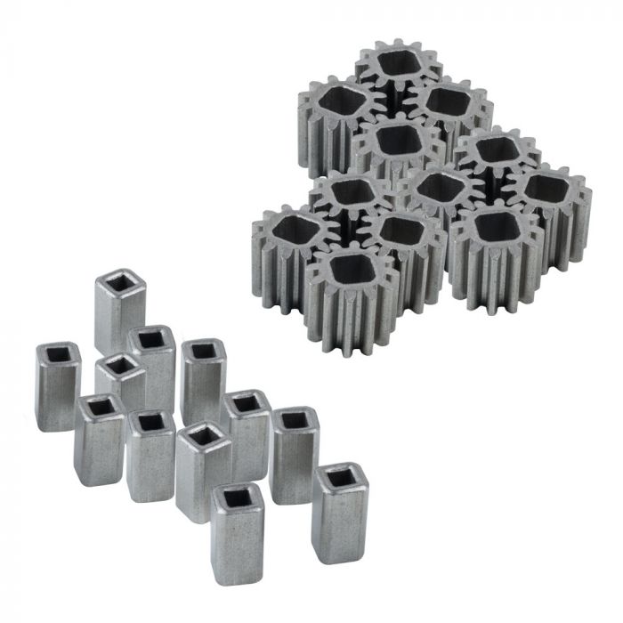

So apparently the holes on the wheels are too small for the high strength metal inserts.
Do I just force it in…? (And just ignore that doing it will damage the plastic wheel body?)
Or should I maybe put the inserts into fridge and hope that it gets a bit smaller???
Thanks…

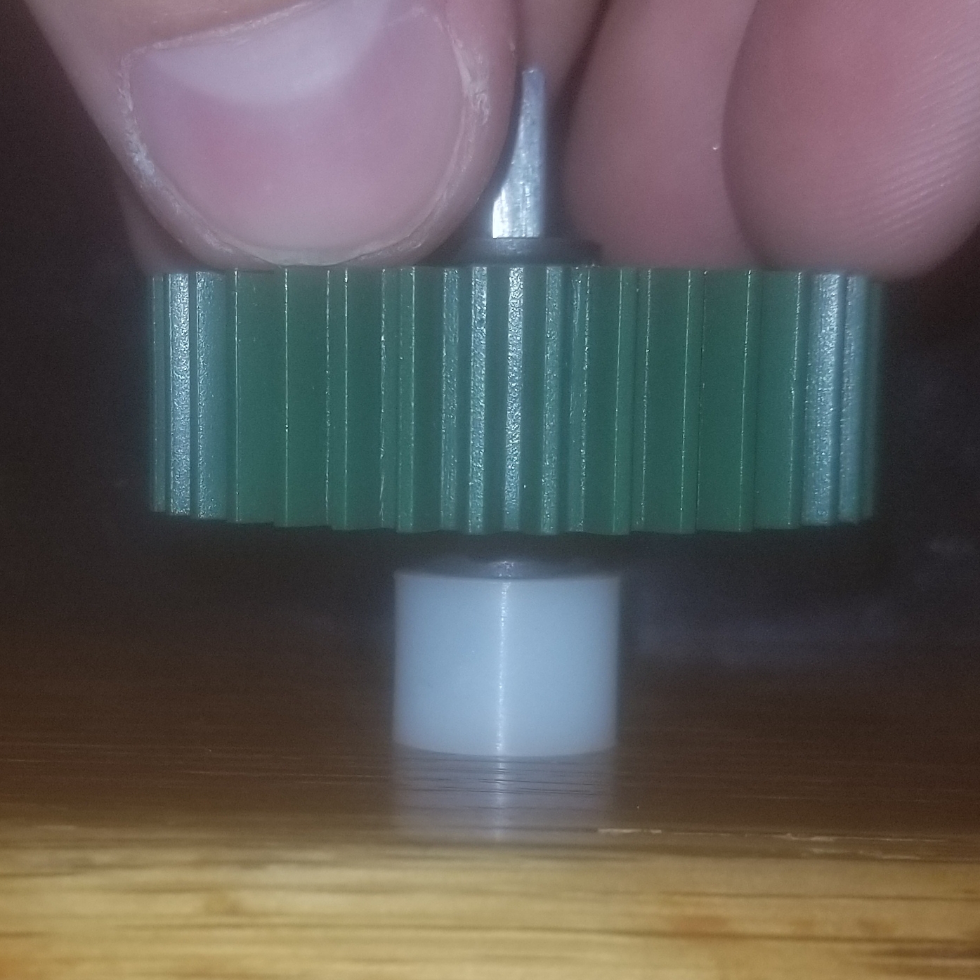

they should fit in without doing any real damage. you may have to give it a tap or two with a hammer.
Put a low strength shaft through the wheel with inserts on both sides. Make sure the inserts are lined up just right with the holes (they can normally go in a little bit easily). Set the wheel on top of a spacer and push down on the wheel (demonstrated on a gear)

My personal method is whacking it with the side of plyers, or compressing between the gear/wheel and a table
Lol yea
I ended up kinda forced them in
That worked!
Used a little different set up but yea that is definitely a great method.
TY
No the holes were just too small for any insert.
I ended up forced them in but shafts are going through nicely, so whatever :slight_smile:
