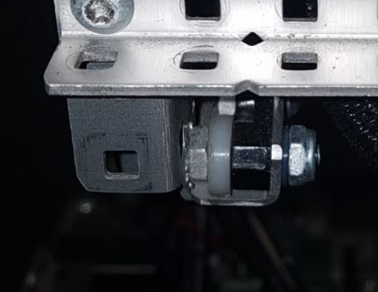

You won’t run into this issue at all if you build a screw joint correctly; that is, with bearings on the joint. You are just talking about putting a screw in a hole freely, which is likely not how most teams do it and is certainly not the best way. My teammates and I did it this way on a six bar we built once, and although this six bar only stayed together for a matter of weeks it had worn out the holes in the c-channel by then, basically making it useless.
Here is (what I believe to be) the correct way:
PilonsScrewJoint
This is the Pilons’ ITZ robot.
I suppose depending on the application it might be beneficial to add a second bearing. Also joint styles slightly vary, just make sure to pin down the all the necessary factors in whatever exact design you might choose.

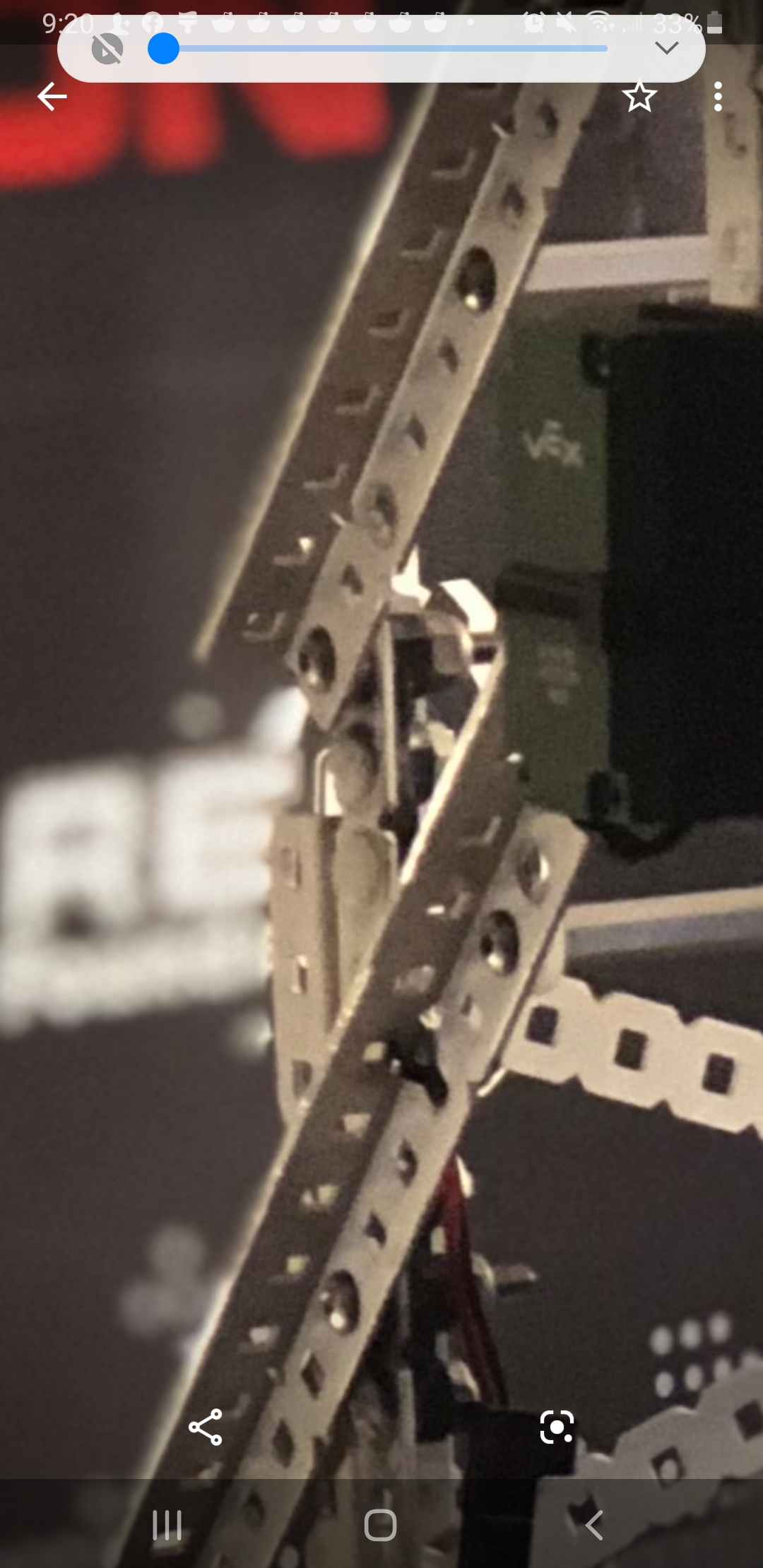

Here is an image from 929u in the zone which used screw joints with 1 bearing on the lift. I believe that a screw joint without a second bearing is better since I like to have the screw mounted securely and not free spinning which is only dependent on the keps nut. Some variants have the keps or locknuts slightly unscrewed to allow free spinning of the screw but I find this does not decrease friction. The reasoning is that the moving components will slip past one another at the point of least resistance. The free spinning screw will cause 2 moving interfaces instead of 1 but both are the same exact level of friction(screw to bearing friction) so it is pointless. Sliding on one interfaces is not preffered over the other. The reason why 1 bearing only is better because the 2 bearing variant introduces extra slop from the slight untightening and adds extra weight, and decreases the effective screw length.

edit: If you are using a second bearing purely for centering the screw in the hole, then I think that is a okay use but not needed. It does ensure nothing gets moved during collisions and use but a tightened keps nut should not come loose and could easily be retightened.
edit2: I will concede that there truly might be a reason why screw joints with 2 bearings is better but I have yet to see it. On the 929U in the zone robot the joint between the RD4B and the lift towers is a 2 bearing joint but with no keps/locknut at all??? They also put these metal one bar flanges on the bearings which completely eludes me.

Okay I think I figure it out, putting a 2nd bearing is just to ensure the screw stays centered in case the keps nut comes loose. I do know that screw joints come loose over time an need to be retightened throughout competiiton. The reason I will still not endorse this method though is because it is trivially easy to retighten the keps nut into the perfect position by feeling for the sweet spot. By shifting it around when it’s loose you will naturally settle into the point of lowest friction.
Yes the second bearing may or may not be beneficial depending on what you are using the joint for. Regardless, how was there a shift in the screw which was damaging to gear mesh if you build all your screw joints correctly? I have never had a screw joint shift around unless it wasn’t built right.
Yep you are right it is totally dependent on how you want to build, how much space is available, and if you want to have to retighten or not.
