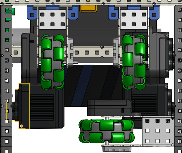

we have our tracking wheels quite close to each other (becuase our frame is too thin to fit them in. Do you think it would be a good idea to use a gyro for the angle calculation in odom?
Also i now realize that they can be pushed one more inch by switching left and right
More data = better. You can use some math like the Kalman Filter to accurately combine the data from the two inputs
Edit: I wouldn’t solely rely on the gyro, as far as I can tell it has less accuracy but more precision(it drifts and will not be as repeatable)
Those are probably too close together. You’s have to do the math though. Calculate resolution and determine if that’s accurate enough for you. For example, small wheels are good, but close together is not. So then at least get rough numbers to compare to see if it is viable for your code

This may sound dumb. But is there a way to mathematically calculate your x y, theta if you kind of “simulate” what the values would be like if the tracking wheels were further apart?
Yeah, most of the equations you can use are most easily accessible in the pilons odom guide. I personally couldn’t derive those equations independently, with my current mathematical background, so I would recommend using the ones they already have
Yes, one of the constants used in the PiLons odom guide is the distance from the tracking center to each wheel. So “simulating” in this case just means substituting a different value for this distance.
well if you just literally substitute the value for something else then deltaL and deltaR wouldn’t be right then. and deltaL and R is what you get from the encoders.
In that case, could you rephrase your original question? What are you trying to ask?
so like you know your delta L and delta R with your current encoders. is there anyway to find that same deltaL and R for a different distance from center?
Say the orange arcs are the “new” deltaL and R
Oh, sure. The ratio between “new” deltaL and deltaR and the old ones will just be proportional to the ratio of the radii from the wheel to the arc center. (So say your deltaR was 10" and your arc length was 20". If you move the wheels 1" out your new deltaR would be 9.5").
