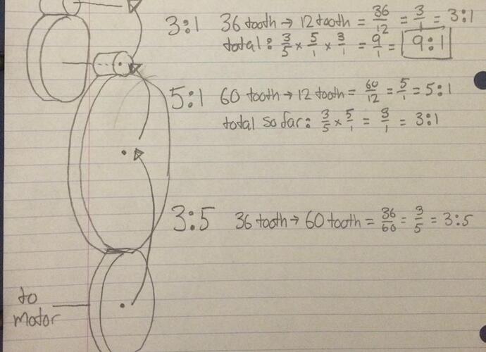

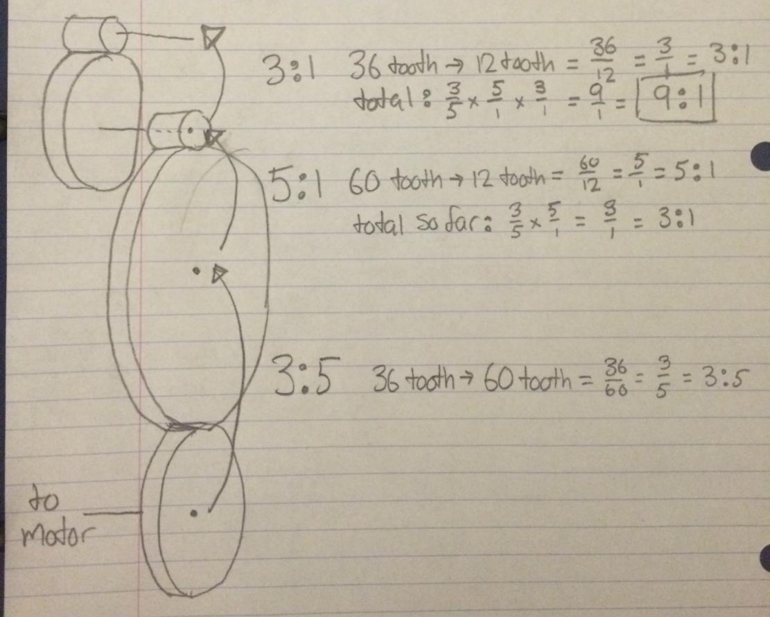

I’m glad to see you’ve fixed your previous problem with your flywheel. Your new structure looks very study–nice work. However, Bot15498 and Vex 9185 are right. Your external gear ratio is actually 9:1, which means your total gear ratio is 2.4 * 9 = 21.6. This gear ratio is too low for a single flywheel with a 5 inch wheel. I thought their explanations were a bit hard to follow, so I drew another explanation (attached). If this makes sense to you, I can help you make a gearbox that will make your flywheel spin fast enough.

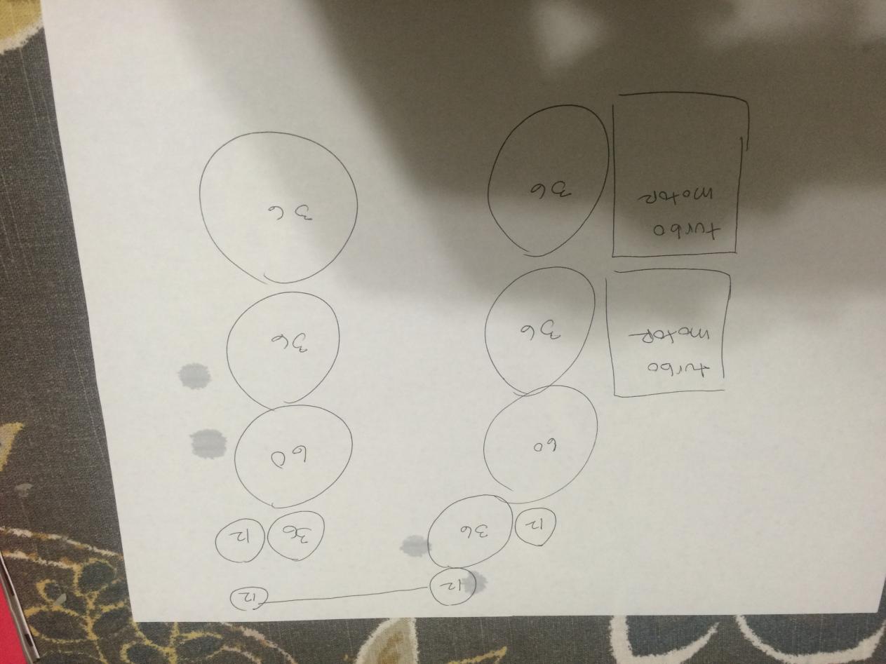

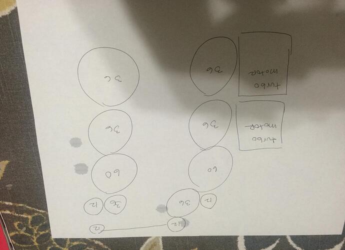

Thanks. Bot and vex were saying that the 60 tooth gear is an idler gear, which makes senses now. But in your diagram, you still calculated the 60 t gear. So for future reference, do I calculate the 36t - 60t(3/5) or skip it and calculate the two 36t and 12ts?
Second, I would love any help I can get. I just want to make it to the competition so that my students don’t feel bad about not completing their robot.
Right now, we are trying to do:
Motor Motor
36t----------36t
--------------84-----12
---------------------_60-----12.
I just don’t know if I’ll have enough power. Any suggestions?

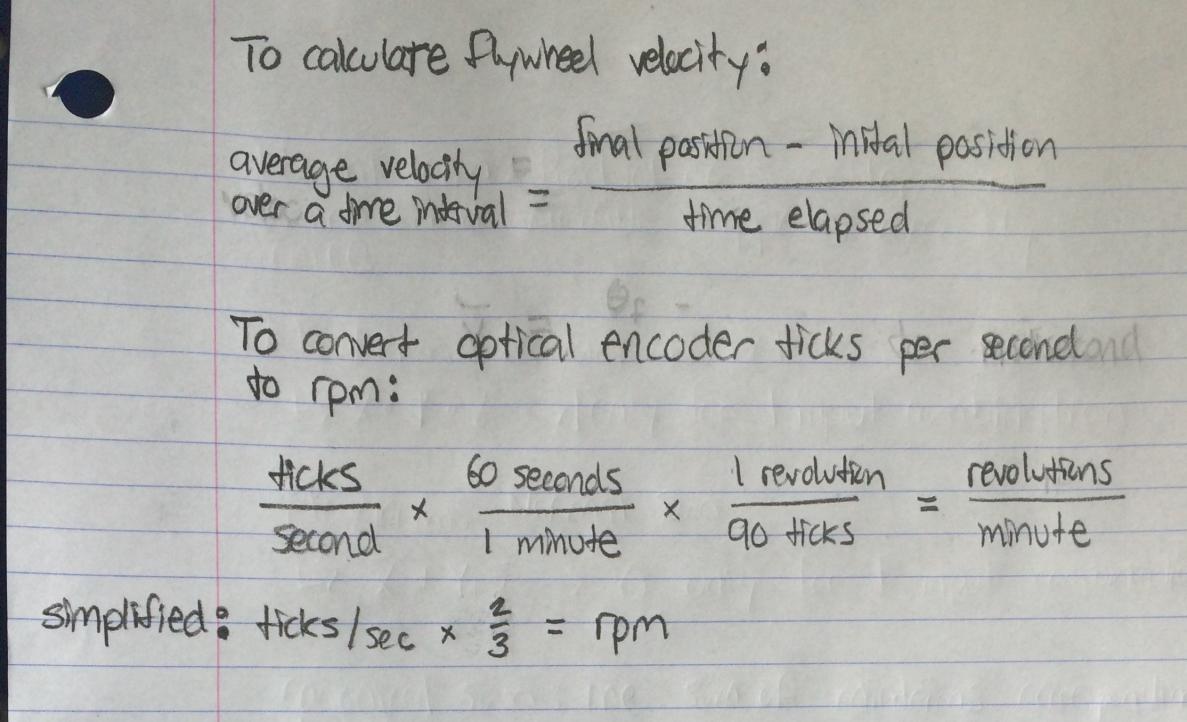

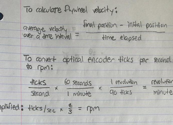

Last, how do I convert information from the optical encoder to rpms? I am using easy c 5.
Thanks so much jnmacdnld
I agree with bpalms, the ball just seems to be rolling off the metal, not being compressed. A single flywheel shooter should have around 35:1 gearbox I think.
Yes, the 60 tooth gear is in fact an idler gear. For future reference, if you can identify a gear as an idler, you can ignore it. But, if you include it, you will still get the correct number.
The external gear ratio you have drawn looks like it’s 35:1. I’m assuming you want to shoot from the back corner. For a robot with a straight back plate, this gear ratio is too high to shoot from the back corner of the field. However, you have a long curved back plate, so your ball will be in contact with your flywheel for a longer time. When the ball is in contact with the flywheel, it presses against the flywheel which in turn presses the flywheel axle against its bearing and creates friction. Since your ball is in contact with your flywheel for a longer time, this friction will have a longer time to slow down your flywheel. So your flywheel will be spinning slower at the time the ball is launched compared to a straight back plate.
Perhaps 35:1 will actually be ideal since it will make make your flywheel spin faster initially, and counteract this effect. On the other hand, maybe the effect I’m describing is actually a very small effect and it won’t matter much at all. I’m not sure exactly sure, since I haven’t ever tried this design before. You’d have to experiment. However, if you do try 35:1 and it ends up being too fast, you can always reduce the motor power setting. The choice is yours.
If you’re okay with shooting from mid-field, I do know that 8059F used a 28:1 ratio with a curved back plate design like yours and was able to shoot from mid-field quite well. So you could try that ratio.
In terms of optical encoders, are you using integrated encoder modules or optical shaft encoders? And do you have enough programming experience for a math formula to be a sufficient answer or would you like an example program as well?
Can I have both please? This is my second year trying to do vex so I don’t have any experience.
We rebuilt the robot again. The 35:1 external ratio seems to not work. There is a lot of friction on one side of the flywheel and I think it’s tripping because it will slow down all by itself. Any suggestions?
Ah. I now see you said you are using Easy C. Unfortunately I’ve never used Easy C so I can’t help you write an exact program. I’m going to assume by optical encoders you mean optical shaft encoders. This page should give you some background on how these work and how to write programs that use them in Easy C. I’ll give you a general overview of what your program should do to calculate the flywheel’s rpm.
First, you calculate the velocity of the flywheel. To do this, first record the initial position of the encoder. Then wait for a specified amount of seconds. Then record the final position of the encoder. Use the formula in the attached image to get the flywheel velocity from this. You will now have the flywheel velocity in ticks per second which is the unit of measure of position for encoders. So, convert this velocity to revolutions per minute using the attached formula.
