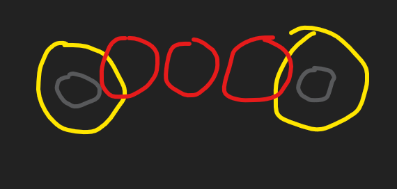

hello and thanks for reading my team and I are having troubles with our ratios its 3 48 tooth gears in the middle and 2 24 tooth gears on the ends its powred by two blue motos one works but the ohter doest when its by its self it works but when combeined with the other gears it justs stops We have zero clue whats going on we saldy cant post photo or video just ask for more deatalis if needed also sorry about the spelling im in a hurry

To answer your question though, it is probably due to a couple of issues:
  1. Assuming your drivetrain looks like the diagram below, if your blue motors are spinning 2 48t gears adjacent to each other, they have to spin opposite directions, and if they are anchored to 2 48t gears not adjacent to each other, they have to spin the same direction.
  2. Putting blue motors on the 48t gear will make your drivetrain insanely fast and have very little torque, so your acceleration will be slow. If you used the smallest wheel size, that’s still over 170 in/sec. Always gear down the speed of 600rpm motors.
Most likely due to your description it is the first one. But I still would recommend changing your build because of #2.
(Yellow circle = wheel, grey circle = 24t gear, and red circle = 48t gear)
if possible, could u make a diagram of teh gears and wheels and motor placement? this would help us figure out your issue.
However, it is probably how @Gigahertz.t said that it is going extremely fast which is likely the problem. also 24 tooth gears are extremely heavy and that prob causes a ton of friction on your 1200 rpm drive. I would definitely reccomend going for 300-600 rpm on your drivetrain. if u keep ur 1200 rpm ur accelleration and torque (strength) would be extremely low and right now it doesnt accelerate so basically it just doesnt spin and get even close to full speed.
