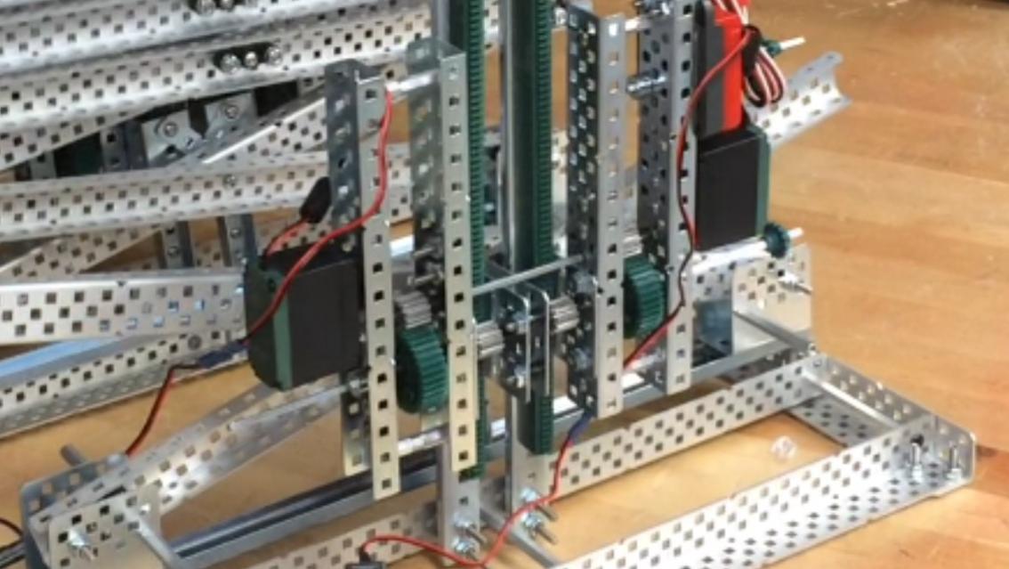

We have a 3:1 gear ratio right now with a 12 tooth powering a 36 tooth which has a 12 tooth in the middle which goes up the vertical tower to lift the scissor. We want to increase the speed but still keep a lot of torque in it.
So would a 2:1 even make a difference noticeably? or what would be better.
Since we have built a huge mechanical mess of a robot, as in it is not fun trying to change things inside of the robot because it takes a long time and we don’t want to waste time if it won’t help it.

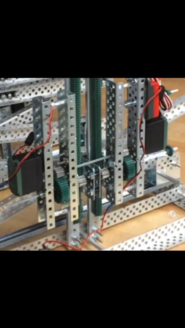

This is what we have.
My better photo won’t upload from my phone. Tell me if that works
I got the better photo now.
I’m going to guess that you want to find the best-suited gear ratio you can; in other words, you want to have the motors geared for as much speed as you can while still being able to lift.
From here you can make a pretty good guess of what gear ratio you need; but why not do the physics/math on it?
torque = radius x force
torque = torque of one motor (provided by VEX)number of motorsgear ratio
radius = length of the member you are trying to turn
force = weight of what you are trying to lift, so game objects, aluminum, steel, screws, motors, pneumatics, intakes, yourself, the field, etc. plus a 15-20 % safety factor. (mostly for friction and other things you might have missed.)
So now we can set up an equation and solve for your gear ratio. This is really pretty easy math.
And now you know the minimum gear ratio you need to lift whatever you want to lift.****
I think I did it right, I got 19.65/1 so basically 20:1 gear ratio. That seems quite large and slow.
